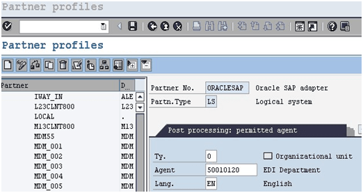

In SAP, all partner systems involved in a distribution model have a profile. There are several profile types, such as customer profiles and vendor profiles. This distinction is generally not necessary and you usually create your partners profiles using a generic logical system type.

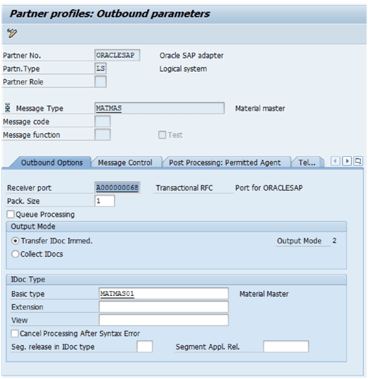

For a receiver partner system (outbound parameters are filled in), the following settings are specified in the partner profile:
The receiver port to which the data will be sent.
The sending method: either one IDoc at a time, or by packets.
The IDoc type that will be sent to that partner. For a given message type, the type of IDoc might vary depending on the receiver system. You might have different versions of SAP in your system landscape.

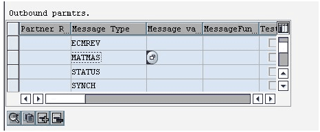

To create a partner profile:
