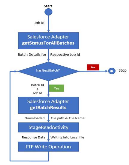

  • Get Status For All Batches: Requests the details of the bulk job primarily for checking job status. Once the job completes, you can fetch the batch results using the Get Batch Results operation. It takes the jobId as input and provides details/status of all batches for the job ID provided.
  • Get Batch Results: Requests the response data for the batches of its respective job. It takes the jobId and BatchId as inputs and downloads a file. The file contains the respective batch response data to Oracle Integration, the response file path, and the file name. This information is available to you in the response mappings.
The functional overview of the integration is as follows:
Description of sf-bulk-summary.png follows
