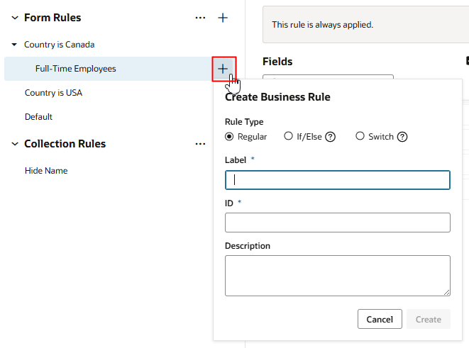

Add a child rule
You can add a child rule to any of your extension rules:

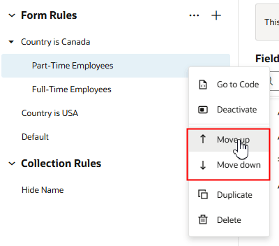

  1. Click Create Rule next to the rule that you want to be the parent rule.
  2. Type the Label of the child rule. (The ID field is automatically populated based on the Label, but you can type a different ID if you want.) Click Create.
  3. Right-click the child rule, and then use Move up and Move down in the options menu to move the rule into the position you want.
    Remember, child rules that are peers are evaluated from the bottom up, so the order is important.
