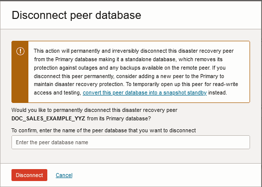

On the cross region peer, on the Autonomous AI Database details page, under Disaster recovery in the Role field click Disconnect peer.
This shows the disconnect peer dialog:
On the Disconnect peer database dialog, enter the peer database name to confirm the disconnect.
Click Disconnect.
Click Disconnect.
