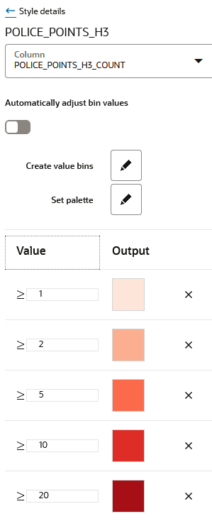

  6. Switch on or off the Automatically adjust bin values toggle button.
    • If turned on, the bin values will automatically update as you zoom in or out on the map.
    • If turned off, Create value bins option appears.
  7. Assign colors to the bins based on data values.
    The following figure shows the Style details panel options:
    The color bins on the H3 map layer gets rendered appropriately for different resolutions as shown in the preceding figure.
