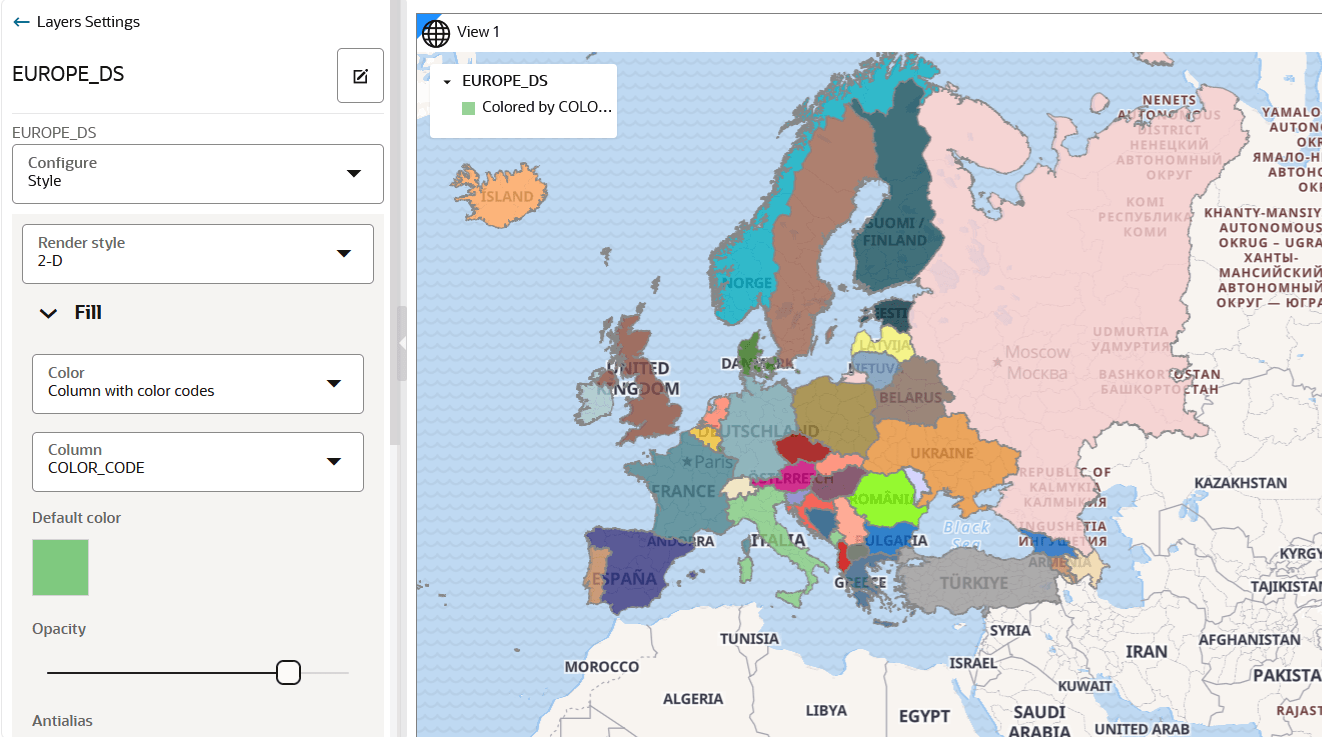

  1. Click Menu Icon against the map layer in the Layers tab of the Layers List.
  2. Select Settings in the context menu.
  3. Configure Style by selecting Column with color codes for the Color value under Fill.
  4. Select the Column that contains the color value.
    The following figure shows the styling of the map layer using the color variable in the dataset:
    The color code gets applied to the map layer.
