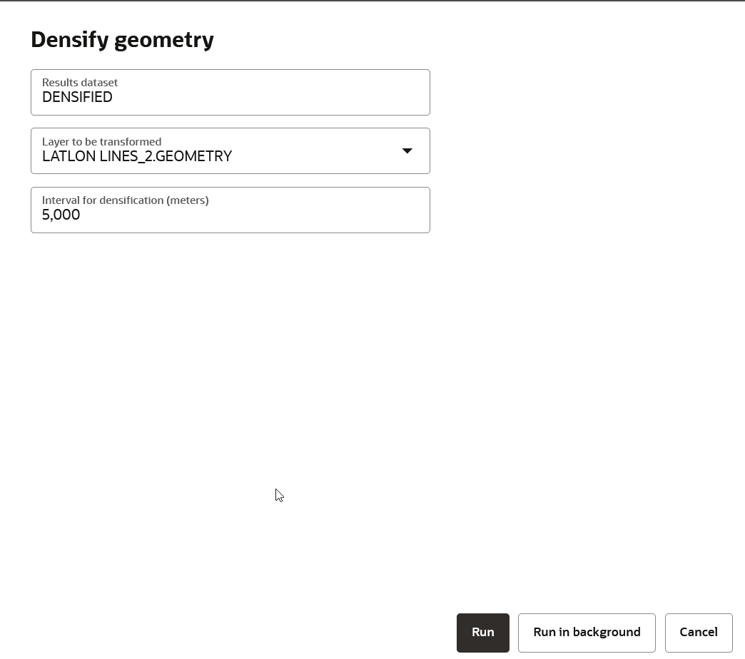

  3. Click the Transform tab and select Densify Geometry.
    Densify Geometry slider opens as shown:
  4. Optionally, modify the Results dataset name.
  5. Select the Layer to be transformed.
  6. Optionally, modify the Interval for densification.
    If the interval is set to too small a value, then the densified geometry may contain a very large number of vertices. This can cause an adverse effect on storage and performance when visualizing or further analyzing them.
  7. Click Run.

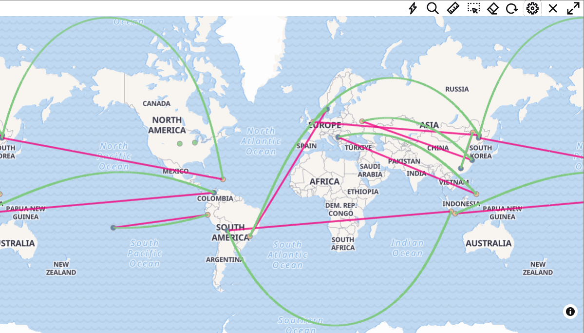

    The following figure shows an example of the Densify Geometry spatial analysis. Considering that the earth is spherical, the densified geometry (in green) is projected as a curve.
