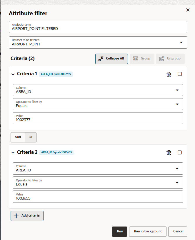

  3. Click the Filter tab and select Return elements filtered by non-spatial rules.
    The Attribute Filter slider opens as shown:
  4. Optionally, change the default Analysis name.
  5. Optionally, change the Dataset to be filtered only if you want to apply the filter criteria against a different dataset. In such a case, Spatial Studio removes any existing criteria associated with the default dataset.
  6. Select the Column name.
  7. Select the Operator to filter by from the drop-down list.
  8. Enter the Value to be filtered.
  9. Optionally, click Add Criteria to repeat from step-6 to step-8 to add as many criteria as required. Also, click the And or Or operator to form the compound query.
  10. Click Run.

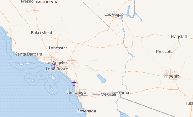

    The Analysis result is listed under Analyses in the Data elements panel on the left pane in the Active Project page.
  11. Drag and drop the analysis result on the map view.
    This creates a new map layer highlighting the geometry for the filtered attributes.
