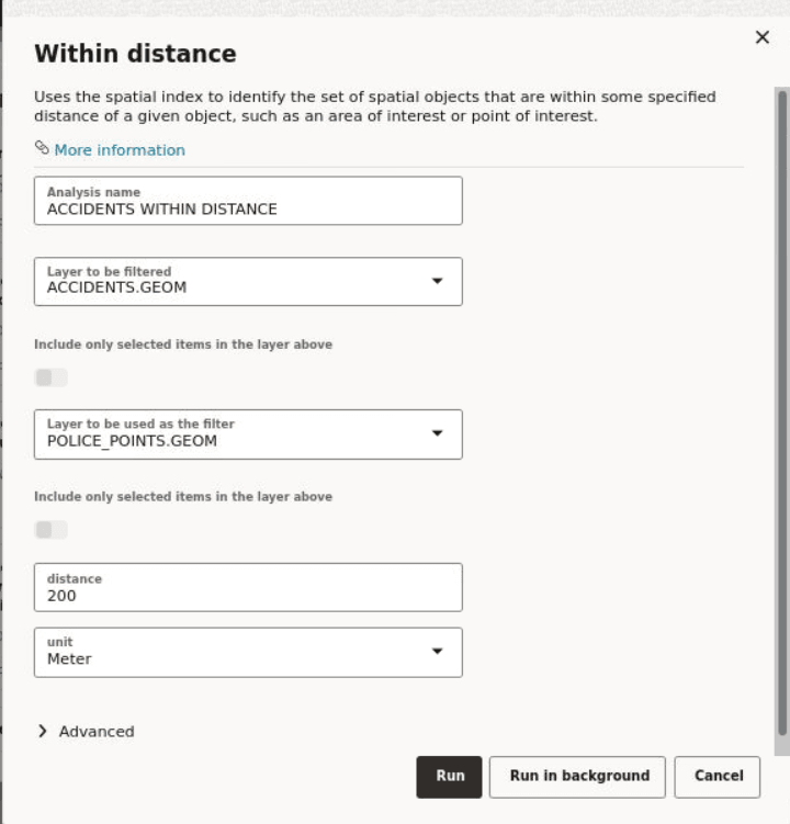

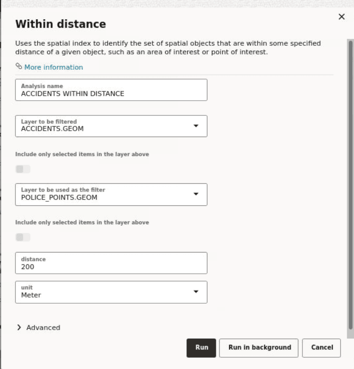

  3. Click on the Filter tab and select Return shapes within a specific distance of another.
    Within distance slider opens as shown:
  4. Enter Analysis name.
  5. Select the Layer to be filtered.
  6. Select the Layer to be used as the filter.
  7. Enter distance and unit.
  8. Click Run.
