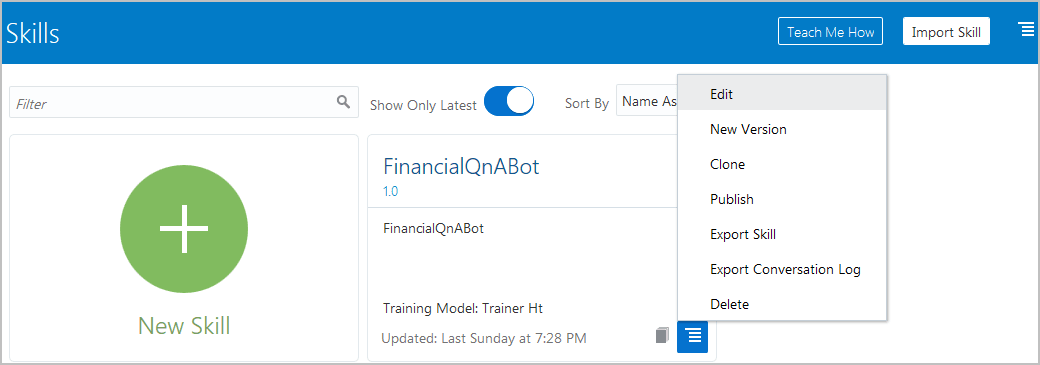

Use the Skill Catalog, which you access by clicking Development > Skills in the side menu, to manage the life cycle of your skills. You can access most of the management tasks from a skill’s Options menu.
When the Show Only Latest switch is turned on in the Skill Catalog, only the most recently updated version of each skill appears. Because the version values are free form, the page uses the date last updated to determine which is the latest version.

Clone
If you want to create a skill that is similar to an existing skill, or if you want to reuse the artifacts of an existing skill, you can create the skill by cloning.
To clone a version of a skill:
From the Skill Catalog, locate the version to clone from.
Click the Options icon, and select Clone.

When you’ve completed building a version, you can lock it down by publishing it. The only modification that you can make for a published skill is to change custom parameter values on the Configuration tab. If you want to make further modifications, you must create another version and work on that one.
To publish a version:
- If the skill has intents or Q&A, make sure it has been trained. You must train it before you can publish it.
From the Skill Catalog, locate the version that you want to publish.
Click the Options icon, and select Publish.
The skill version in the Skill Catalog now has a lock icon to show that it’s published.
Export a Skill to Another Instance
If you have multiple Digital Assistant instances and you want to copy a skill from one instance to another, you use the Export and Import commands:
Log in to the instance that you want to export the skill from.
Click
to open the side menu and select Development > Skills.
In the tile for the skill that you want to export, click
and select Export.
A zip file with the skill will be downloaded to your system.
