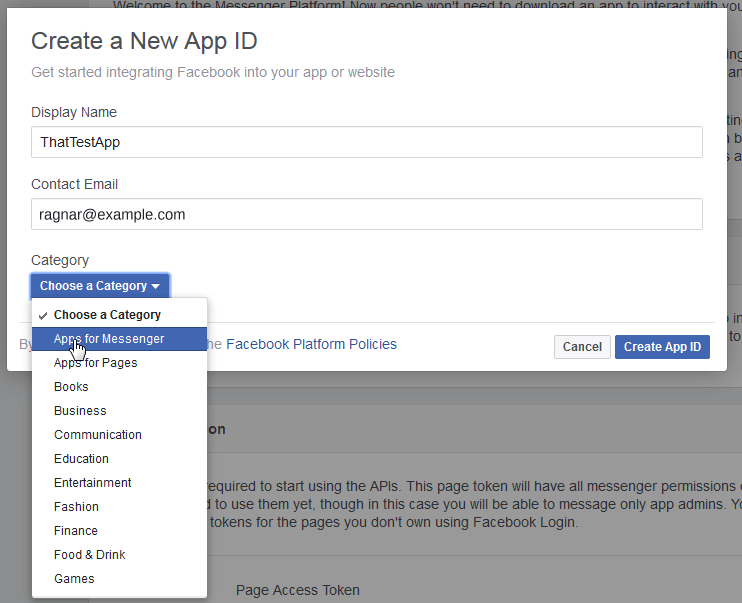

  2. Create the Facebook app that you’ll use for the channel:
    1. In your browser, go to https://developers.facebook.com/apps/.
    2. Select the My Apps tab and click Create App.
    3. On the App details page of the Create App wizard, enter the name you want to use for the app and the email address you want to use as the contact for the app. Then click Next.
    4. On the Use cases page, under Filter by, select Business messaging. Then select Engage with customers on Messenger from Meta and click Next.
    5. Click through the rest of the pages in the wizard and then, on the Overview page, click Create App.

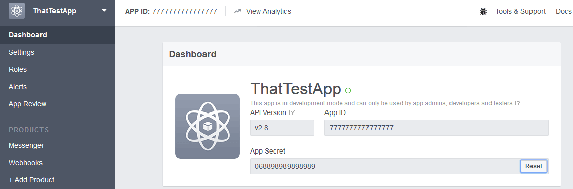

  3. Once the app is created, select the app (on the left side of the My Apps page), and then, in the App Settings section, select Basic.
  4. Copy the value of the App secret field and paste it somewhere convenient on your system.
    You’ll need the app secret later on to complete your Facebook channel configuration.

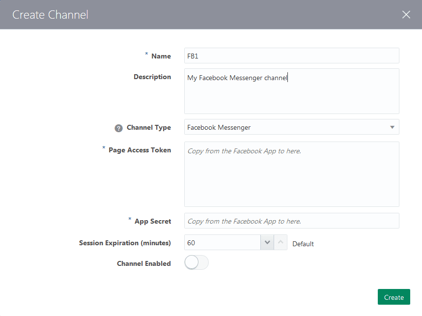

Complete the Create Channel dialog by providing the Page Access Token and App Secret keys from Facebook.
  1. In Digital Assistant, click Channels in the left menu and then choose Users.
  2. Next, click Add Channel to open the Create Channel dialog.
  3. Give your channel a name.
  4. Choose Facebook Messenger as the channel type.
  5. In the Page Access Token field, paste the page access token that you generated previously in the Set Up Facebook Messenger procedure.
  6. In the App Secret field, paste the app secret that you copied previously in the Set Up Facebook Messenger procedure.
  7. Click Create.

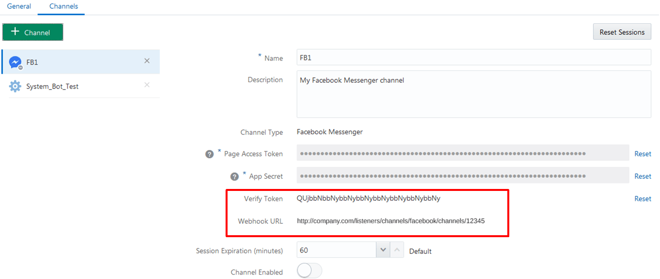

  8. In the Channels page, copy both the Verify Token and WebHook URL and paste them somewhere convenient on your system. You’ll need these to configure the Facebook webhook.
    Description of fb_channel_complete.png follows

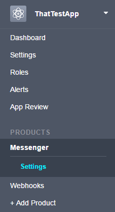

  1. In the Facebook Messenger console, go to the project that you initially created for the webhook.
  2. Select Messenger API Settings to open the Messenger API Setup page.

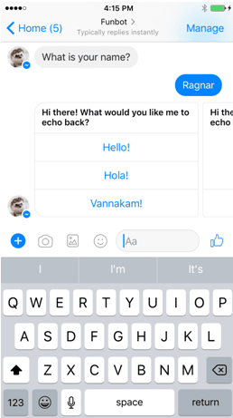

Step 5: Test Your Bot on Facebook Messenger
With the Facebook Channel and messaging configuration complete, you can test your bot using your Facebook page, Facebook Messenger (https://www.messenger.com/) and the Facebook Messenger app on your device.
  1. Go to https://www.messenger.com/.
  2. Within the Messenger interface, enter the name of your page to search for the page.
  3. Start chatting with your digital assistant (or standalone skill).

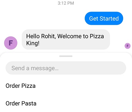

Persistent Menu
Facebook Messenger enables you to create a persistent menu next to its Message field. See https://developers.facebook.com/docs/messenger-platform/send-messages/persistent-menu/ for details on the feature.
Here's an example that shows persistent menu items for "Order Pizza" and "Order Pasta":
Create a Persistent Menu Item
To add persistent Facebook menu items for a digital assistant or a standalone skill, you do the following:
  1. Make sure that you have all of the prerequisites in place, including a get started button.
    Those prerequisites are listed here: https://developers.facebook.com/docs/messenger-platform/send-messages/persistent-menu/#requirements
  2. Add an action for each menu item in the Facebook persistent menu's call_to_actions array, as generally described at https://developers.facebook.com/docs/messenger-platform/send-messages/persistent-menu/#set_menu.
  3. Set the persistent menu items with a POST call to the Messenger Platform API.
    The request URI is https://graph.facebook.com/v2.6/me/messenger_profile?access_token=<PAGE_ACCESS_TOKEN>, where <PAGE_ACCESS_TOKEN> is the page access token for your Facebook app.
