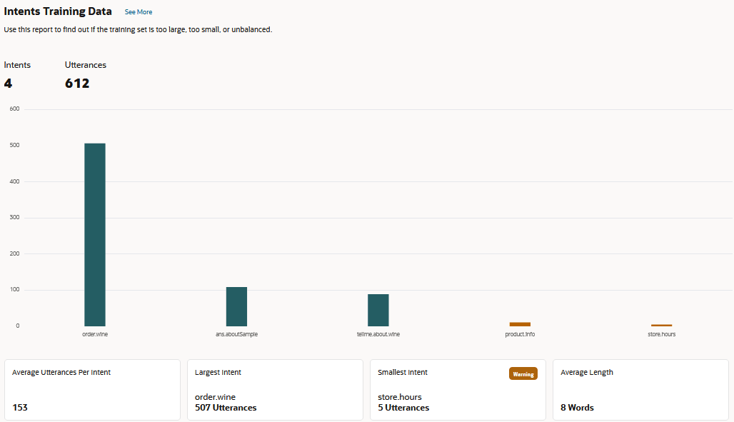

The Overview report provides you with views of your training data.
  • A high-level view of the training data through its intents-by-utterance-count bar chart and metrics, which include the total number of intents and utterances across all versions of the skill. Using the bar chart and the metrics, you can find out what these totals mean in terms of how balanced or unbalanced your training set has become. For example, the report's graph, along with the disparity between the Largest intent and Smallest intent totals might indicate a lopsided training set, one where you need to add data to close the gap between the largest and smallest intent.

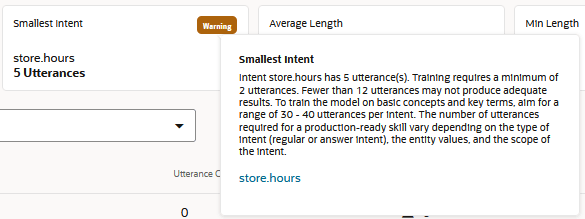

    The report flags problem areas with warnings. Hovering over a warning opens a diagnostic message, which puts the problematic utterance or intent in the context of our intent and utterance guidelines and suggests corrective actions.
    This is an image of a warning message.
    Tip:
    The warning messages accessed from the metrics provide you with a link to the Intent page.
    These messages also display in the Intents Issues pane.

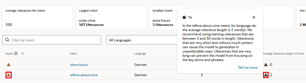

  • A breakdown of the training set on a per-intent basis. The report includes a table listing intents by language (for multi-lingual skills), utterance count, and average, minimum, and maximum word length. To see the latter three totals in context of the overall training set, compare them to the Average length, Min Length and Max Length metrics.
    As with the high-level metrics, the report flags intents problematic intents with warning messages. A warning This is an image of the Warning icon. in the Issues indicates that the intent is deficient in some aspect of utterance length. Clicking the corresponding warning This is an image of the warning icon. in the Average Utterance Length, Max Utterance Length in Words, or Min Utterance Length in Words columns opens a diagnostic message. You can apply the corrective action suggested by the message directly to the intent by clicking the link in the Intent column.
    Description of intent-issues-table.png follows

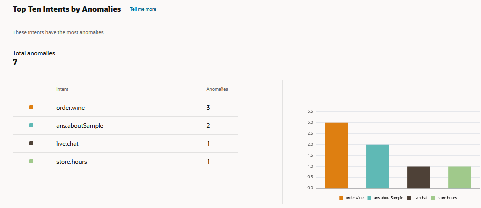

This report not only ranks the intents by anomalies, but also ranks the anomalies themselves by how different they are from other utterances in the training set.
Description of anomalies-intent-breakdown.png follows

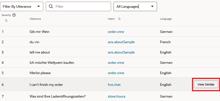

You can sort the anomalies in this list both by severity and by intent. You can filter the anomalies by intent, by words or phrases in utterances, and for a multi-lingual skill, by language.
To find out where (or if) an utterance belongs in your training set, click View Similar in the list to view it in the Similar Utterance report.
Description of anomalies-list.png follows

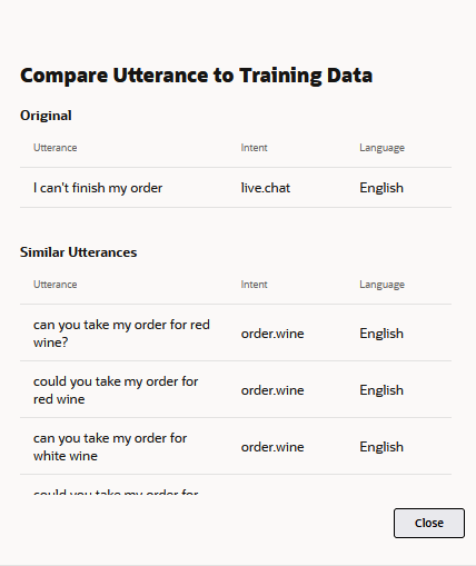

Like the Similar Utterances report used in the Utterance Tester, this report ranks the other utterances in the training set relative to the selected utterance. In this case, however, the utterance isn't a test phrase, but an anomalous utterance that's already in the training set.
Description of similar-utterance-report-anomalies.png follows
Based on the anomaly's relationship to the other utterances in the report, you may find that the utterance is simply misclassified or not pertinent to the skill at all. Other anomalies, however, may only be anomalous to the other utterances in that they are implicit requests – they are asking the same questions as the other training data, but in a different way. For example, "I can't log into my account" might be evaluated as an anomaly for an agent transfer intent whose training utterances cluster around more straightforward requests like "I need to talk to a live agent." Adding similar utterances will add depth to the model.
