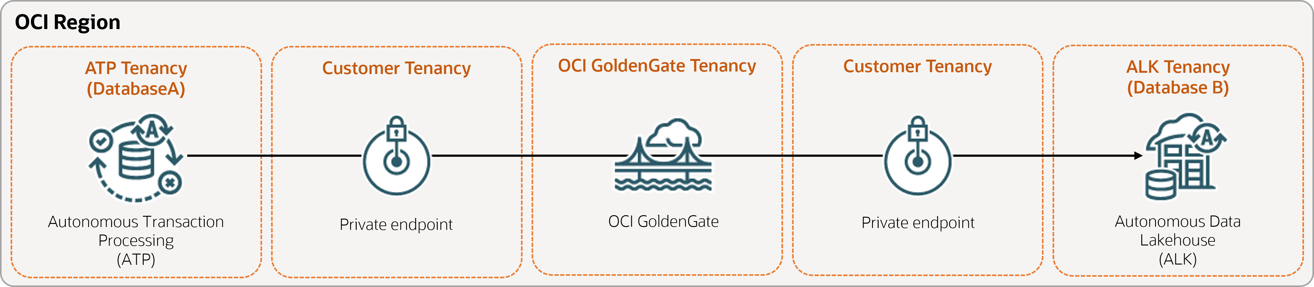

Learn how to set up Oracle Cloud Infrastructure GoldenGate to replicate data between two Autonomous AI Databases.
Overview
Oracle Cloud Infrastructure GoldenGate lets you to replicate supported databases within the same region. The following steps guide you through how to instantiate a target database using Oracle Data Pump and replicate data from the source to the target.
This quickstart is also available as LiveLab: View the workshop
Description of same-region.png follows
