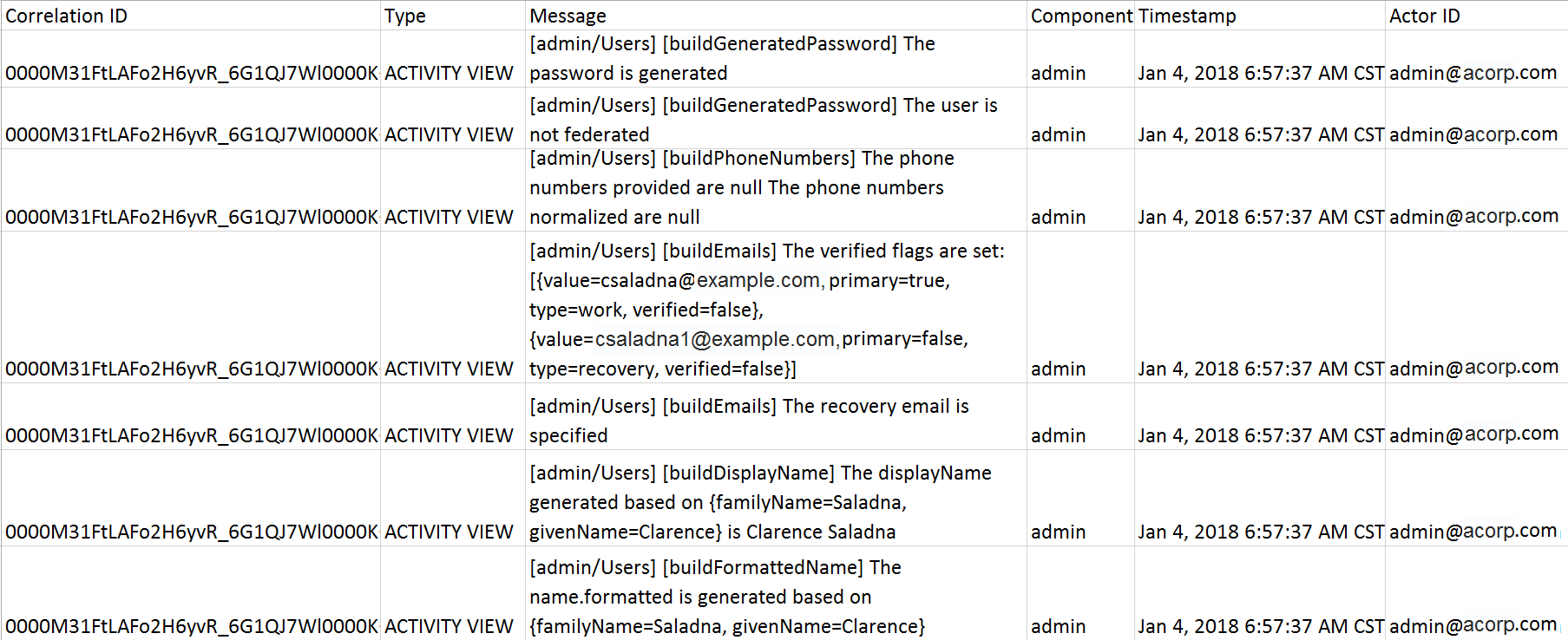

Use the Oracle Identity Cloud Service Diagnostic Data reports to view logging data captured for diagnostic purposes. You can locate the ECID and the RID in the report, and then correlate those identifiers to the ECID and the RID that are returned by the Oracle Identity Cloud Service REST calls that your applications make. See Running the Diagnostic Data Report.

A section of the diagnostic report that was generated when the POST request on the
/Usersendpoint was run.

}Diagnostic Report Sample
