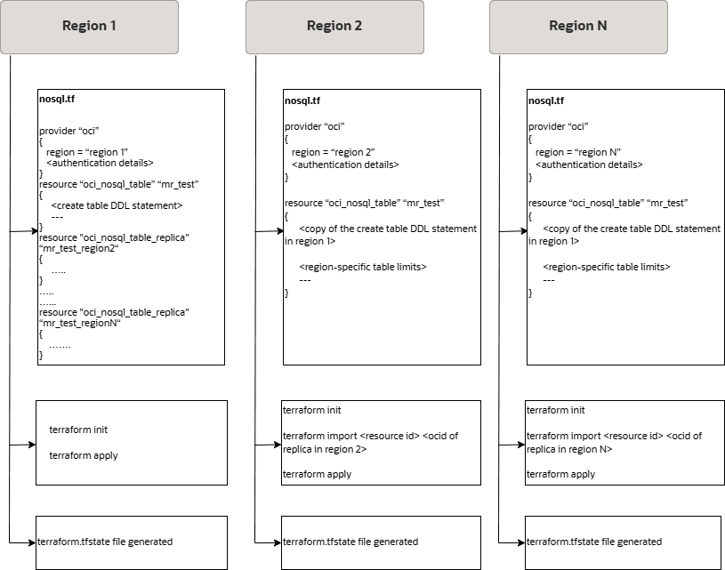

Edit the table limits of a regional replica
The OCI provider in Terraform is configured for a single region. Since table limit updates are region-specific, you can manage the read and write units of a replica created in ca-toronto-1 only from the Toronto region. Similarly, if you want to manage the table limits of the different regions of your global active table, we recommend you to structure your modules in terraform as shown below. Here, Region 1, Region 2 etc. are directories within your Terraform directory. Terraform directory is the one that gets created when you install Terraform.
Description of terraform.png follows
In the Terraform directory, maintain separate directories for each region and maintain the configurations (represented as nosql.tfin the above diagram) with region-specific table limits within them. The terraform state files (terraform.tfstate) are also created and managed separately for each region.
In our case, we would have three directories inside the Terraform directory corresponding to the three regions, us-ashburn-1, ca-montreal-1, and ca-toronto-1. Let us call the directories Ashburn, Montreal, and Toronto.
Steps to modify replica table’s read/write units in ca-toronto-1 region:
  1. Navigate to the Toronto directory. Create a Terraform configuration (here, nosql.tf) by duplicating the oci_nosql_table resource definition from the configuration used in the US East (Ashburn) region.
  2. Update the table’s read and/or write units as needed.
    resource "oci_nosql_table" "mr_test" {
      #Required
      compartment_id = var.compartment_ocid
      ddl_statement  = "CREATE TABLE IF NOT EXISTS mr_test(id INTEGER,
                        name STRING, info JSON, PRIMARY KEY(id))
                        with schema frozen"
      name           = "mr_test"
      table_limits {
        #Required
        max_read_units     = 100
        max_write_units    = 90
        max_storage_in_gbs = 1
  3. Import the existing table into your Terraform state. As shown in the diagram above, the state file is also region-specific and hence importing the table does not create any state conflict. You can get the ocid of the replica table in Canada Southeast(Toronto) region from the OCI console.
    terraform import oci_nosql_table.mr_test <ocid-of-replica-table-in-ca-toronto-1>
