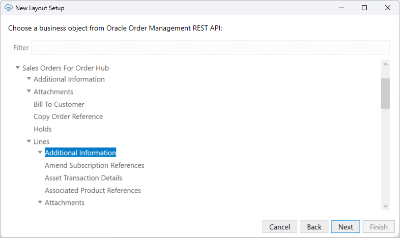

  2. Follow the instructions in the wizard, selecting a business object as the primary business object when prompted in the second screen.
    If you want the layout to use an EFF business object, select it here. If you want to add the EFF to a dependent layout, you’ll do this in the fourth screen.
    In this example, the Additional Information business object is selected for the layout.

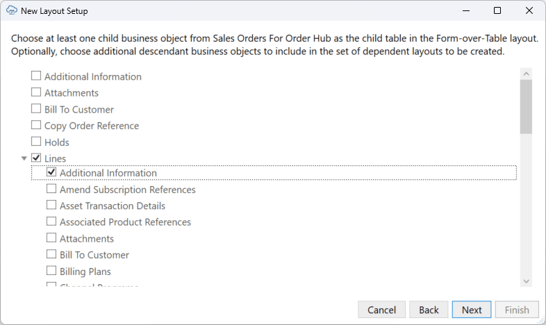

  4. When you reach the fourth screen of the wizard, you are prompted to select descendant business objects for your layout or layouts.
    If you want to add the EFF as a dependent layout, select it here. In this example, Lines as well as the EFF, Additional Information, are selected.
