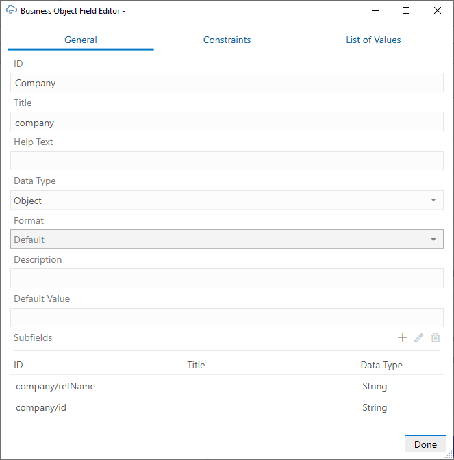

  1. Open the Business Object Editor for the “contact” business object, then click the Fields tab.
  2. Click Add Field ( Add Field icon ), then provide details for the Company field:
    • ID: company
    • Type: Object
    • Subfields: Add two subfields of type string with ID values of “company/refName” and “company/id”.
    Note: Keep in mind that IDs are case sensitive and must match the NetSuite JSON member names exactly.
    Provide Title and Help Text values as desired.
