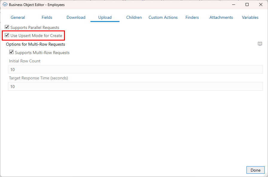

You enable upsert mode by selecting Use Upsert Mode for Create from the Upload tab of the Business Object Editor.
Note: This check box is only available for ADF REST services and is hidden for all other service types.
When upsert mode is enabled, the add-in sends the HTTP header, Upsert-Mode: true, with POST requests for single-row creates. For multi-row requests, the add-in sets the operation value for each batch part to “upsert” instead of “create”.
