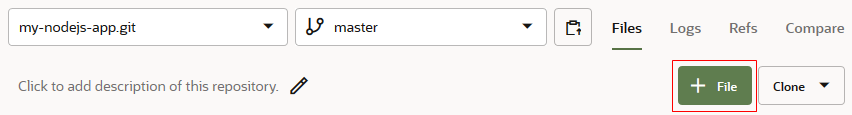

- From the Repositories list, select my-nodejs-app.
- Click + File.
Description of the illustration git_populated_repo.png - In File Name, enter
