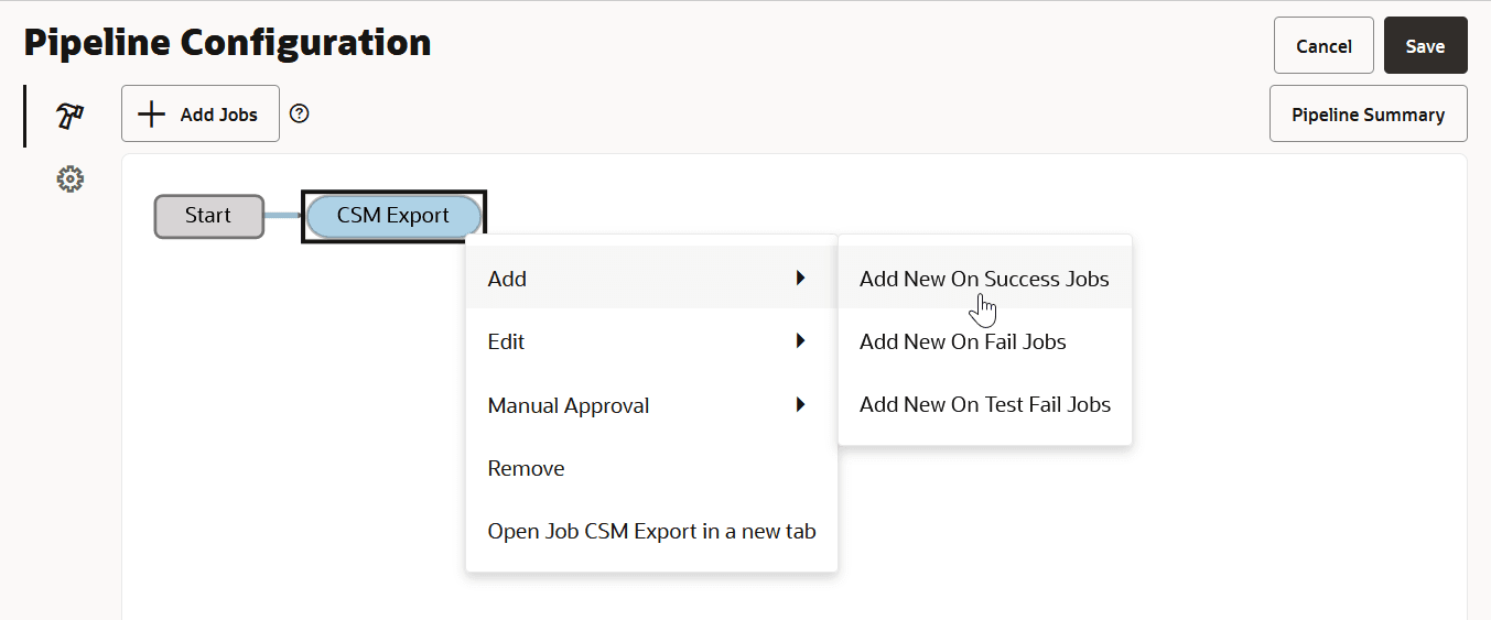

  9. Right click the node you just added and select Add then select Add New On Success Jobs. Description of pipeline-add-new-success-csm-jobs.png follows
    The Add New On Success Jobs dialog box is displayed.
  10. Click in the Select new on success jobs area to choose new jobs that will execute if this job runs successfully. Select one or more jobs from the list displayed. Description of pipeline-add-new-success-csm-jobs-dialog.png follows
    Description of the illustration pipeline-add-new-success-csm-jobs-dialog.png
  11. Click Save. The Pipeline Configuration windows displays the Start node, the node with the build job you previously selected in step 7, and the node with the build job you just selected, all connected by lines that end in an arrow. Description of pipeline-two-csm-nodes.png follows

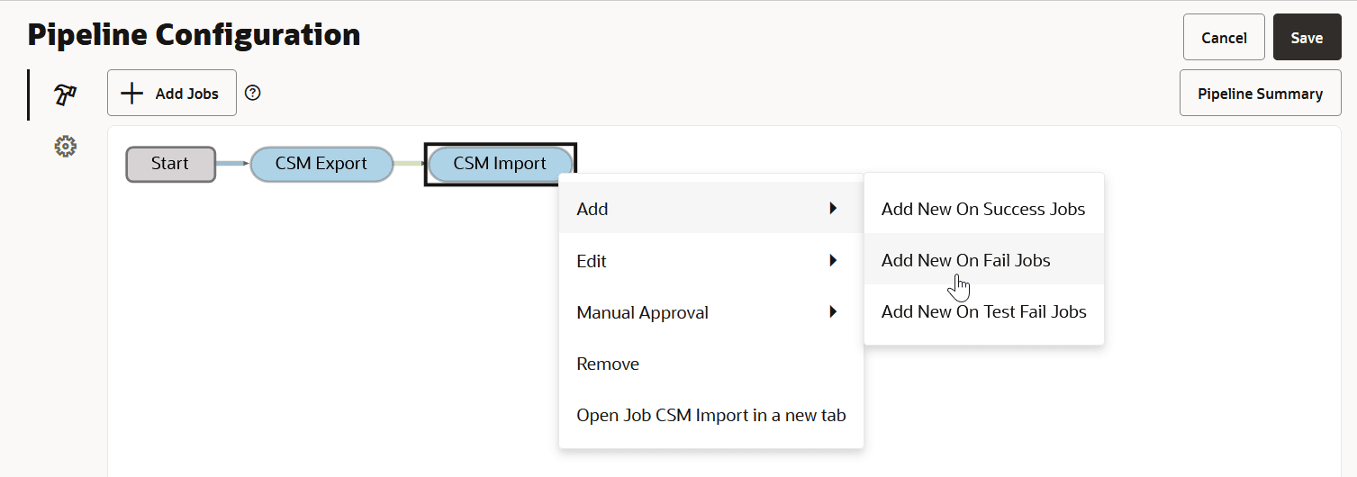

  12. Right click the node you just added and select Add then select Add New On Fail Jobs. Description of pipeline-add-new-fail-csm-jobs.png follows
    The Add New On Failure Jobs dialog box is displayed.
  13. Click in the Select new on failure jobs area to choose new jobs that will execute if this job’s run fails. Select one or more jobs from the list displayed. Description of pipeline-add-new-failure-csm-jobs-dialog.png follows
    Description of the illustration pipeline-add-new-failure-csm-jobs-dialog.png
  14. Click Save. The Pipeline Configuration windows displays the Start node, the node with the build job you previously selected in step 7, the node with the build job you previously selected in step 10, and the node with the build job you just selected, all connected by lines that end in an arrow. Description of pipeline-three-csm-nodes.png follows

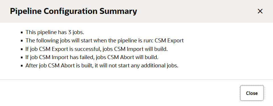

  15. Click the Pipeline Summary button to display a summary screen that provides many details about the pipeline configuration, similar to the example shown here. Description of csm-pipeline-configuration-summary.png follows
