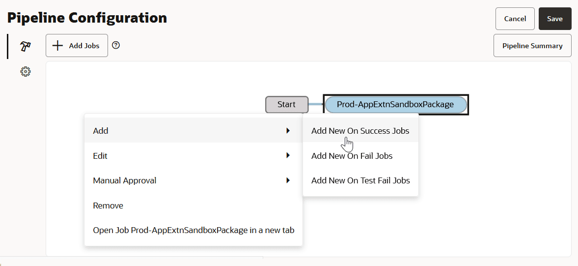

  9. Right click the node you just added and select Add then select Add New On Success Jobs. Description of pipeline-add-new-success-jobs.png follows
    The Add New On Success Jobs dialog box is displayed.

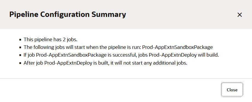

  12. Click the Pipeline Summary button to display a summary screen that provides many details about the pipeline configuration, similar to the example shown here. Description of pipeline-configuration-summary.png follows

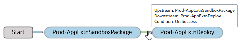

    To see even more information about each item in the pipeline’s configuration, move the mouse over the node or connection you want to learn more about. For example, in this pipeline configuration, if you hover over the the connection between the Prod-AppExtnSandboxPackage and Prod-AppExtnDeploy nodes, you’ll see this information displayed. Description of pipeline-mouse-over-info-connection-prod-appextndeploy-node.png follows
    Description of the illustration pipeline-mouse-over-info-connection-prod-appextndeploy-node.png
