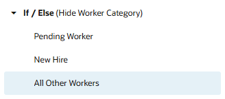

  6. Add and configure additional child rules.
    You can add as many child rules as you want, and arrange the order they are listed.
    Let’s add a child rule that is applied to all other worker categories, and move the rule below the New Hire rule.
    Click Edit to define the conditions, and then set the property overrides you want the rule to apply.
At runtime, starting with the first rule, the rules are evaluated in order until a rule is applied. In this set of nested rules, the last rule is applied only if the worker category is not Pending Worker or New Hire.
