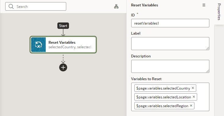

Add a Reset Variables Action
You add a Reset Variables action to reset variables to their default values, as specified in the variable definitions.
To add a Reset Variables action to an action chain:
  1. Open the Actions editor, for example, at the page level.
  2. Create an action chain, or open an existing action chain to add the action in the editor.
  3. Drag Reset Variables from the Actions palette into the action chain.
    You can drag the action onto the Add icon (  Add icon  ) in the action chain, or between existing actions in the chain. The Properties pane opens when you add the action to the chain.
  4. Update the ID field in the Properties pane to make the action more easily identifiable.
  5. From the Variables to Reset list, select the variables you want to reset.
