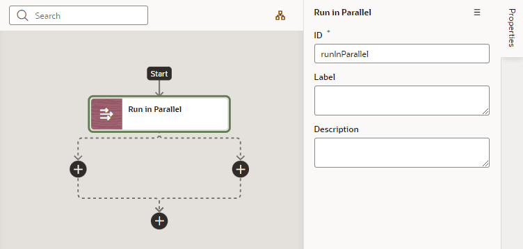

  3. Drag Run in Parallel from the Logic section of the Actions palette into the action chain.
    You can drag the action onto the Add icon (  Add icon  ) in the action chain, or between existing actions in the chain.
  4. Update the ID field in the Properties pane to make the action more easily identifiable.

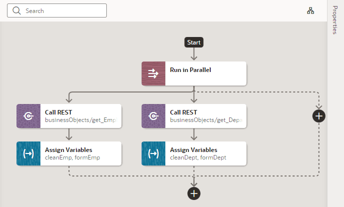

  5. Click each Add icon (  Add icon  ) under the Run in Parallel node to define the actions you want to run in parallel, for example, you could make two REST calls, then do some assignments only after they both complete:
