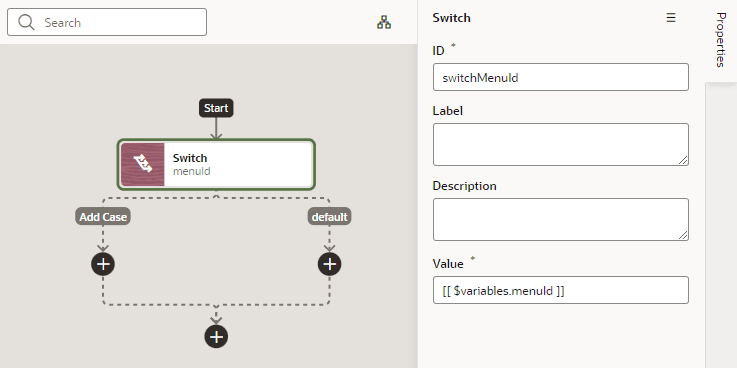

  5. In the Value property, enter a value that should be used as the outcome value. If this property is null or undefined, the outcome is "default".
    For example, when a menu defines a set of options, you can use the Switch action to perform actions for each menu item. In this case, you’d pass the menuId input parameter containing the selected menu item’s ID in the Value property:

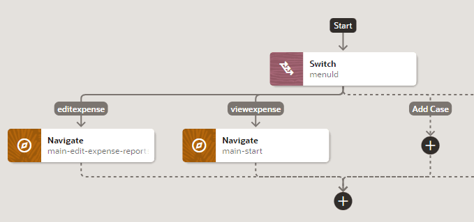

  6. Optional: You can add further actions for each case. For example, if you want to navigate to a particular page when the menu item is selected, you can add a Navigate action for each menu item.
    1. Click the Add icon (  Add icon ) under Add Case.
    2. In the Add Case dialog, enter the case value to be used as the outcome. In our menu example, you would specify the ID of each menu item. Again, if this property is null or undefined, the outcome is "default".
