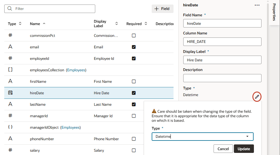

  1. From your business object’s Fields editor, select the field whose type you want to change.
  2. Under Type in the Properties pane, click Edit icon next to the current data type.
  3. Select the type you want to change to and click Update.
