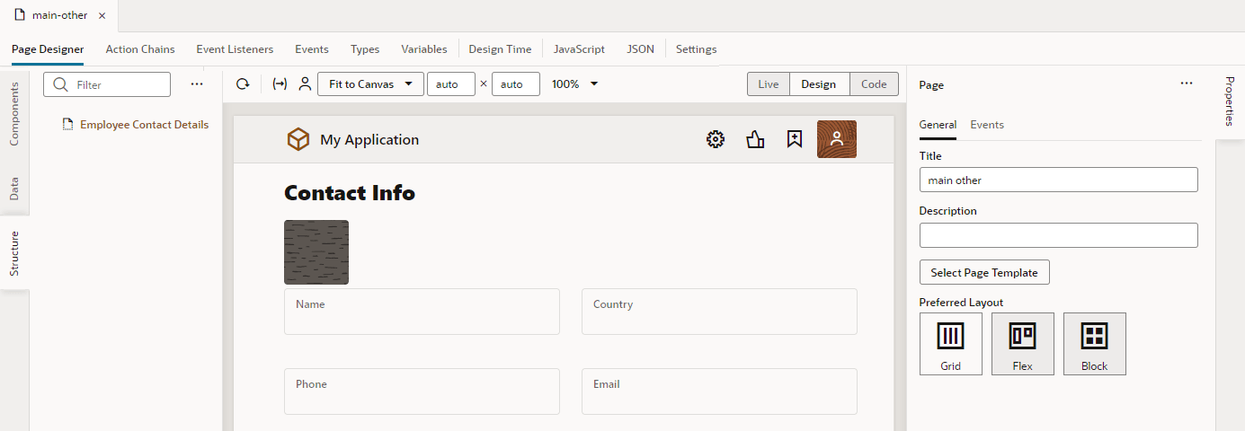

  1. Open the page with the associated pattern or fragment. For example, here’s a page that was created with the employee-contact-details fragment as a page template:
  2. To view the page’s Properties pane, make sure no component or element is selected on the page. If you need to, simply click an empty area on the page.
  3. Click Select Page Template in the Properties pane.
