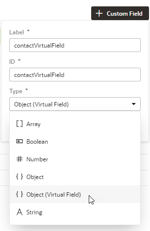

Click the Fields tab, then + Custom Field.
Enter a label for the field (the field’s display name) and select the Object (Virtual Field) type. Click Create.

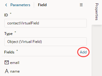

In the Properties pane, click Add next to Fields and select the fields you want to include as reference fields. You can add any field in your layout as a reference field, including sub-fields of objects.

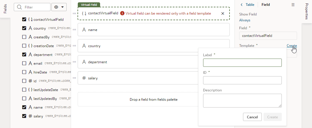

While your virtual field is selected, define a field template for the virtual field when you add it to a layout.
If a suitable field template for the virtual field already exists, you can select it in the Template drop-down list in the Properties pane.
If no template exists, click Create and enter a name for the template in the Label field. Click Create to open the new template in the editor.
