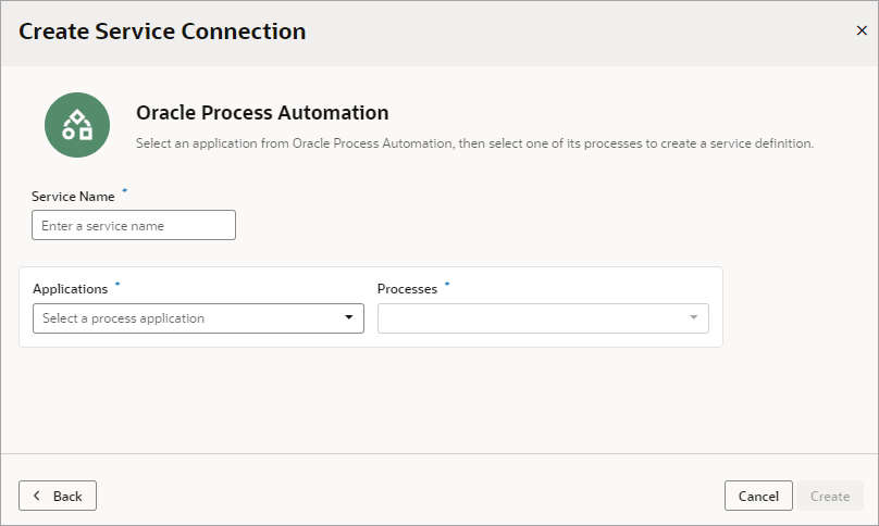

  4. Select the OCI Process Automation catalog.
  5. Enter these details for the OCI Process Automation service:
    1. Service Name: Enter a name for the service.
    2. Applications: Select the Process Application with the OCI Process Automation process you want to use.
    3. Processes: Select the OCI Process Automation process, in the process application, to which you want to connect.
  6. Click Create.
