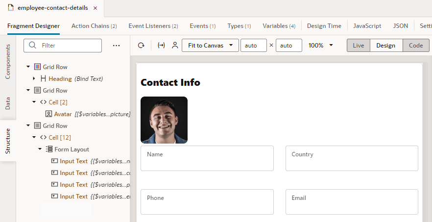

  1. Set up a fragment to display an employee’s contact information. For example, here’s one that uses different components to display employee contact information:

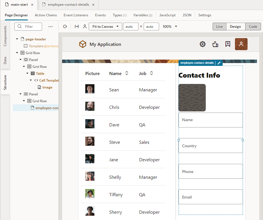

  3. Now open the page where the employee-contact-details fragment is used (drag and drop the fragment onto the canvas, if needed). If it isn’t already, make sure the selectedEmp variable is defined for the page.
