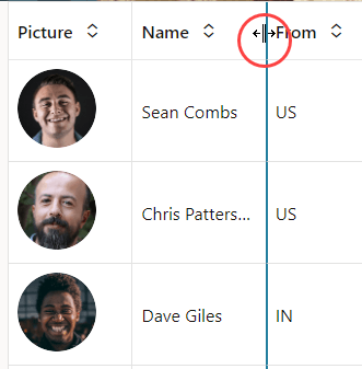

    If you now switch to Live view, you should be able to resize the Name column:
