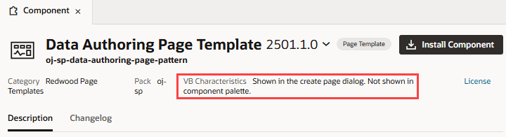

Note: If the component you installed does not show in the Components palette, open it from the Components pane and check VB Characteristics to see why. For example:
If you installed a Redwood pattern that’s meant to be a page template (for example, the Data Authoring Page Template), you’ll find it in the Create Page dialog, not in the Components palette.
