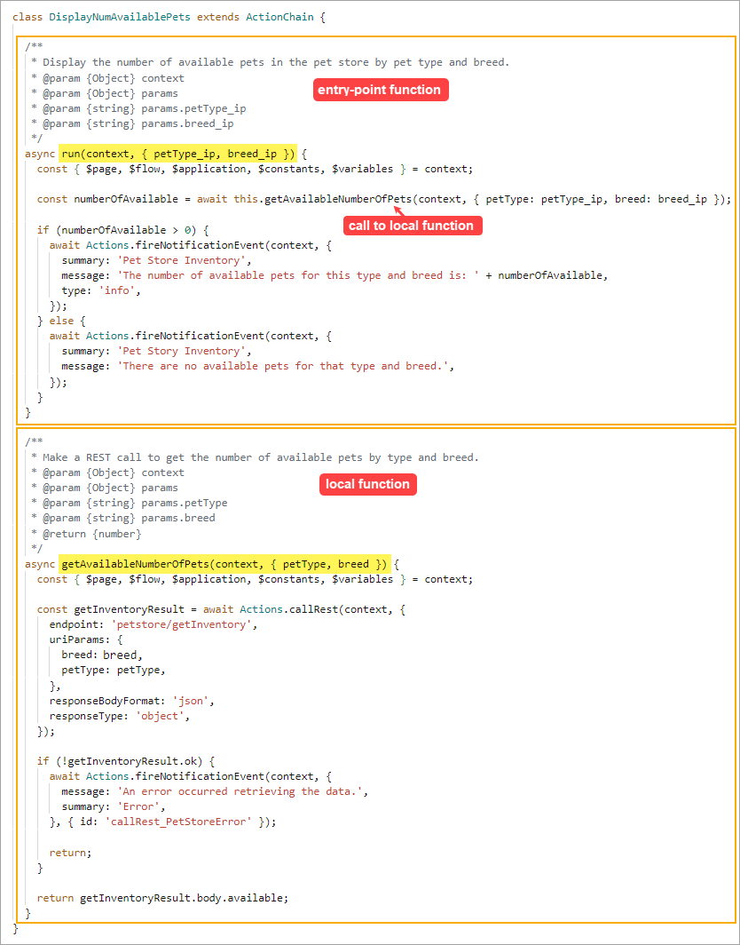

</tr> </tr> </tbody> </table> For details about the API parameters for each built-in action, see [JavaScript Actions](https://www.oracle.com/pls/topic/lookup?ctx=en/cloud/paas/visual-builder/visualbuilder-building-applications&id=VBPMR-GUID-B0AD9B7E-C7FA-4332-8827-B8C964CCBF4C) in the *Oracle Visual Builder Page Model Reference*. ## Local Functions {#GUID-065717DA-BE21-4582-AE57-00DCE8BF9096__GUID-7FC473C0-6BF1-455F-B639-A7271AF168D8} Should the need arise to break up the `run()` entry point function into modular parts, you can create local functions: ![](images/jsac-local-function-code-example1.png " ") [Description of the illustration jsac-local-function-code-example1.png](img_text/jsac-local-function-code-example1.html)
