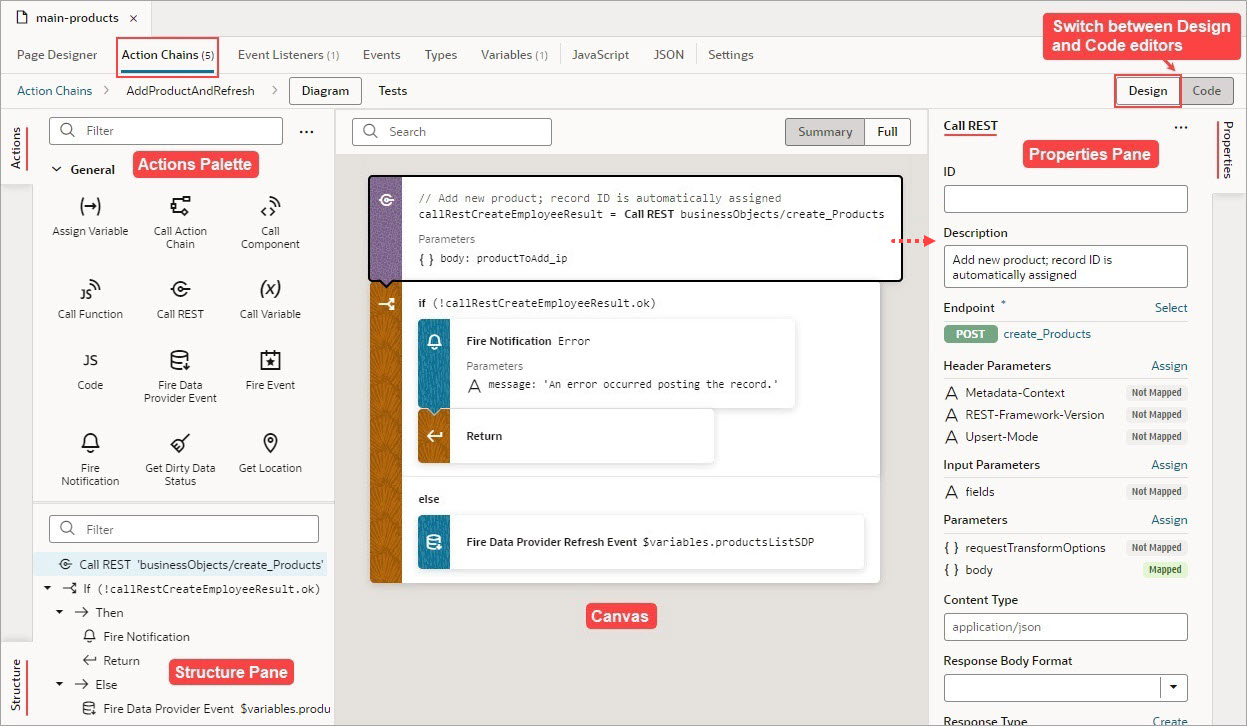

Create Action Chains in Design View
When you use the Actions palette, Properties pane, and Structure pane in Design view, VB Studio writes the corresponding JavaScript behind the scenes. You can edit this code directly at any time by switching to Code view, which opens a code editor.

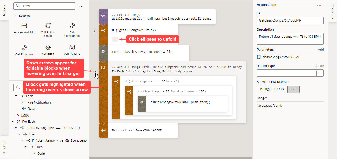

To visually simplify large action chains, you can fold (collapse) the code blocks for If, Switch, Run in Parallel, and For Each actions. To do so, hover over the canvas’s left margin and click the down arrows for the blocks of code to fold. To unfold a block, click the corresponding right arrow or ellipses on the action card:

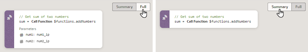

You can further visually simplify an action chain by hovering over the canvas’s upper-left corner and clicking the Summary button that appears. The Summary button hides the input parameter details for each action, except the Assign Variable and Reset Variables actions. The Full button switches back to displaying them:
If you prefer to construct your action chain using code, click the Code button at the top-right of the screen to open a code editor. Typically, one uses Design view to visually add and configure an action, then switches back to Code view to work directly with the code, as needed.
