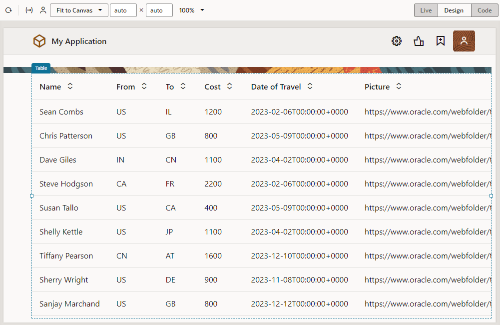

Here’s how a table mapped to data in a business object (done using the Add Data quick start) displays by default:

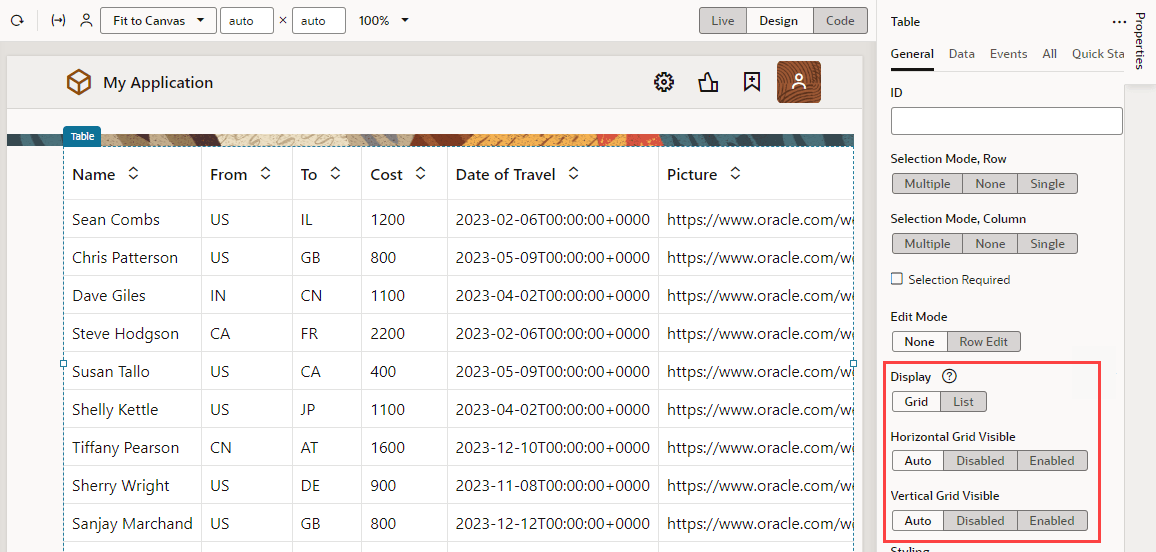

By default, tables display as a list. To switch the list view to a more compact grid view:
  1. Select the table on the page to view its properties.
  2. Select Grid under Display in the Properties pane’s General tab.
  3. If you want to hide the horizontal and vertical gridlines, select Enabled for the Horizontal Grid Visible and Vertical Grid Visible properties.
Here’s how the table looks in grid mode (with the horizontal and vertical gridlines still visible):

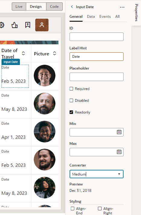

  1. Drag an input date component from the Components palette and drop it directly onto a date-based column (Date of Travel, in our example). The component automatically picks up the existing value.
  2. Update the component’s properties, for example, you can use the Converter property to set the format of the date:
    You might also want to clear the component’s Label Hint field, so Date does not appear in the column.
