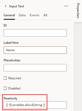

    3. Switch to the Fragment Designer and bind each Input Text component’s Readonly property to the allowEditing variable. For example:
      1. Click the Name Input Text component, then in the component’s Readonly field in the General tab, click Select Variable to open the Variables picker and select allowEditing under fragment variables.
      2. Add an exclamation mark (!) before the dollar sign ($) to indicate that the field is read-only when the fragment is not in edit mode.
