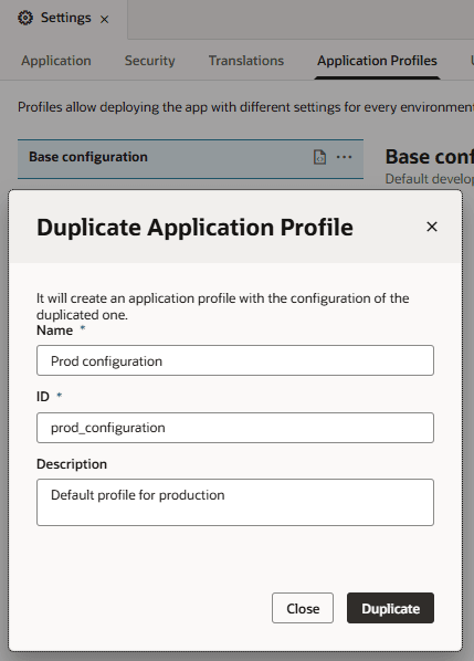

    1. Click Menu in the upper right corner and select Settings, then click Application Profiles.
    2. From the Base configuration’s menu, click Duplicate, then provide a new name (for example, Prod configuration) and description in the Duplicate Application Profile dialog. Click Duplicate.

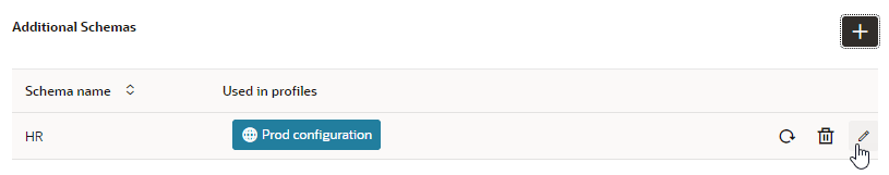

    But the Business Objects tab on the Settings editor provides a more visual way to map schemas to profiles, as described here:
    1. Click Menu in the upper right corner and select Settings (if necessary), then click Business Objects.
    2. Under Schema Selection, with your schema already selected, click Add Schema next to Additional Schemas.
    3. Select an available schema (for example, HR), then from the Used in profiles list, select the profile you want to associate the schema with. You can add more than one profile if you want.
    4. Click Add.
      The schema (mapped to the profile) appears under Additional Schemas. If you want to update the profile, click Edit icon in the schema’s row and make changes in the Used in profiles column. You can change the selected profile as well as add other profiles.

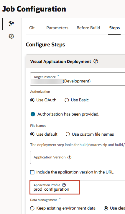

  3. Associate the profile with the build job that deploys your visual application to the particular environment.
    1. Click Go to project page icon at the top left of the header to get to the VB Studio navigator.
    2. In the VB Studio left navigator, click Builds Builds .
    3. In the Jobs tab, find your application’s production deployment job.
    4. Click Configure Configure icon .
    5. On the Job Configuration page, click the Steps tab, then in the Application Profile field, enter the ID of the app profile you want to use. Click Save.
