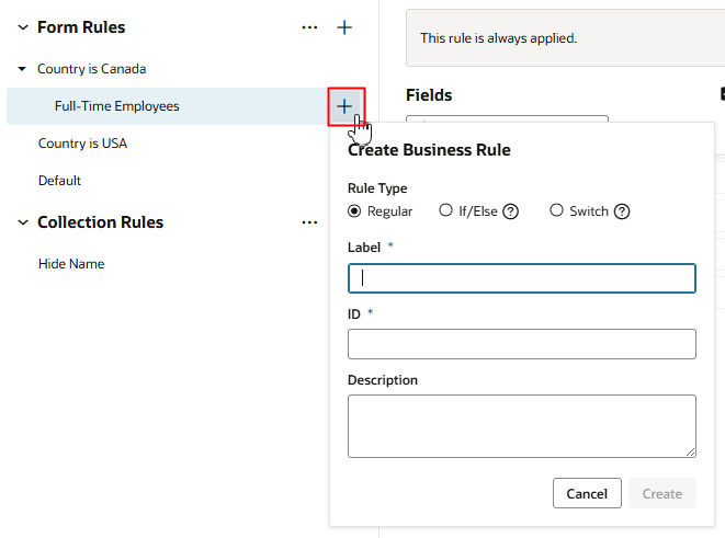

Add a child rule
You can add a child rule to any of the rules you’ve created:
Click
next to the rule that you want to be the parent rule.
Type the Label of the child rule. (The ID field is automatically populated based on the Label, but you can type a different ID if you want.) Click Create.
