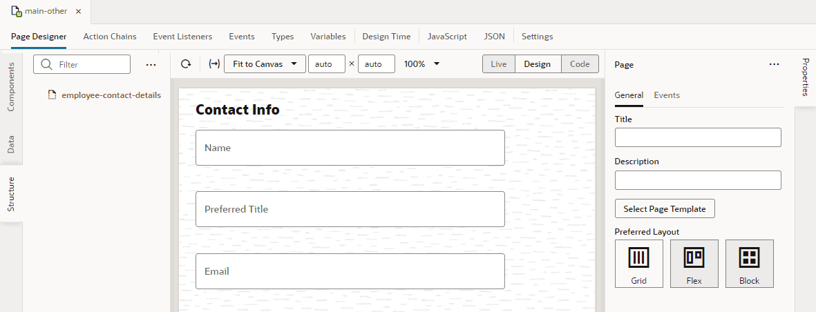

- Open the page with the associated pattern or fragment. For example, here's a page that was created with the employee-contact-detailsfragment as a page template:
- To view the page's Properties pane, make sure no component or element is selected on the page. If you need to, simply click an empty area on the page.

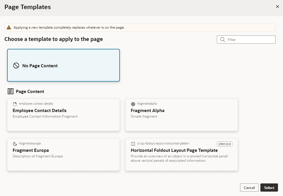

- Click Select Page Template in the Properties pane.
- In the Page Templates dialog, make your choice:- To clear all existing content on the page, select No Page Content.
- To replace existing content with a fragment, select the fragment you want to use. The fragment you want to use must be tagged with the pagemetadata in the Used For field, which allows it to surface as page content.
- To replace existing content with a pattern, select the pattern you want to use. The pattern you want to use must be installed to your application from the Components tab in the Navigator.
- Click Select.
