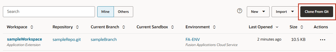

  2. Click Workspaces in the left navigator (or select Manage Workspaces on the Project Home page), then click Clone from Git:
    Description of clonefromgit1.png follows
    Tip: You can also create a workspace from the Git repositories page: Click Git Git , then Create Workspace.

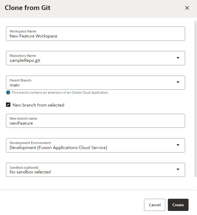

  3. Enter a name for your workspace.
  4. Select the Git repository to clone. If you’re cloning from the Project Home page, the repo is already selected for you.
  5. Select the repository branch that has the changes you want in your workspace. This is typically main for the latest changes, but it can be any branch.
  6. (Optional) Select New branch from selected and enter a name for the branch you want to create. You can create additional branches and switch between branches in the workspace.
  7. If multiple environments are available, select the Development Environment for your extension. Only environments that are in the same identity domain as the logged-in user are listed. (If only one environment is available, it is automatically selected for you.)
    Note: Environments with Oracle Cloud Application instances connected via Basic Auth or OAuth are not supported for extension development and will not show in the Development Environments list. To use that instance for development, you’ll need to create a new environment, then add the instance as an IDCS resource using the Identity Domain option.
  8. (Optional) Select the sandbox you want to use with this workspace, if any.
    Description of clonefromgitdialog.png follows
  9. Click Create.
