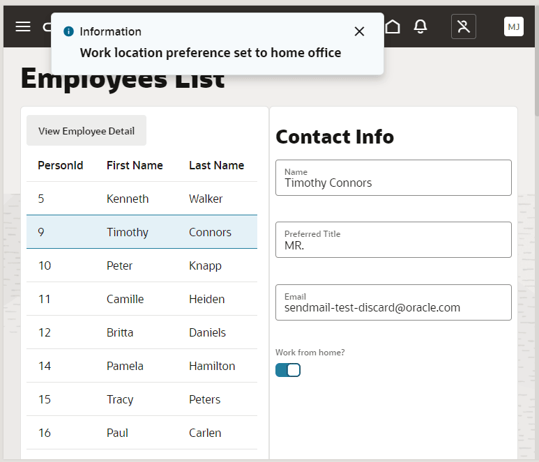

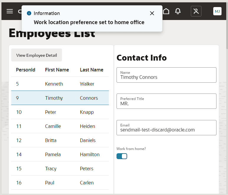

Let’s extend the employee contacts use case to see how to do this. Here, the employee contact information fragment lets you specify whether home is the employee’s preferred work location. A user who toggles the Work from home? switch in the fragment will see a notification that the employee’s preferred work location has been set to home:
Description of fragment-data-email-scenario-test1.png follows
Behind the scenes, when the user toggles the Work from home? switch, an action chain defined on the fragment fires an event that “emits” the event’s payload to the fragment container. An event listener on the fragment container, watching for this fragment event to fire, triggers a page-level action chain to perform some action—which, in our example, is firing a notification that the selected employee’s work location preference has been set to home.

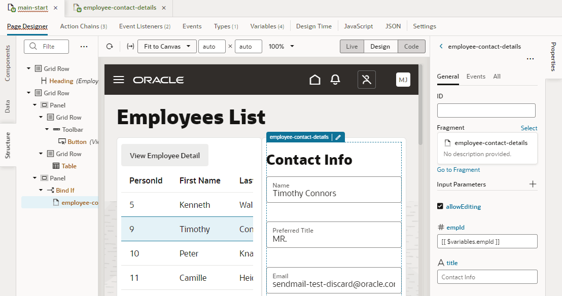

  1. Configure your fragment to raise a custom event that the parent container listens to. Here’s an example of a page that pulls in the employee-contact-details fragment:
    Description of fragment-pagesetup.png follows
    1. From the fragment’s Properties pane on the page, click Go to Fragment to access the Fragment Designer. You can also click the Fragment edit icon icon that appears next to the fragment name on the canvas.

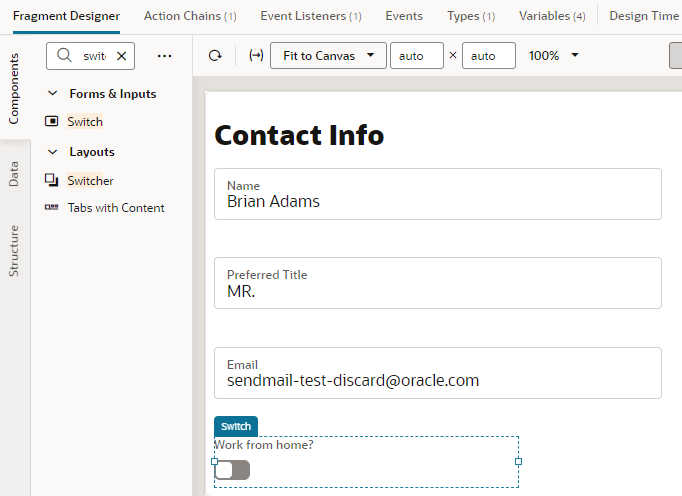

    2. Drag and drop a Switch component in your details fragment.
    3. In the Properties pane, change the Label Hint text in the General tab to Work from home?.
      Description of fragment-designer-switch-data.png follows

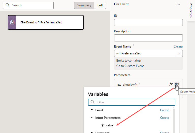

    5. In the SwitchValueChangeChain action chain, drag and drop a Fire Event action.
    6. Click Create next to Event Name in the Properties pane.

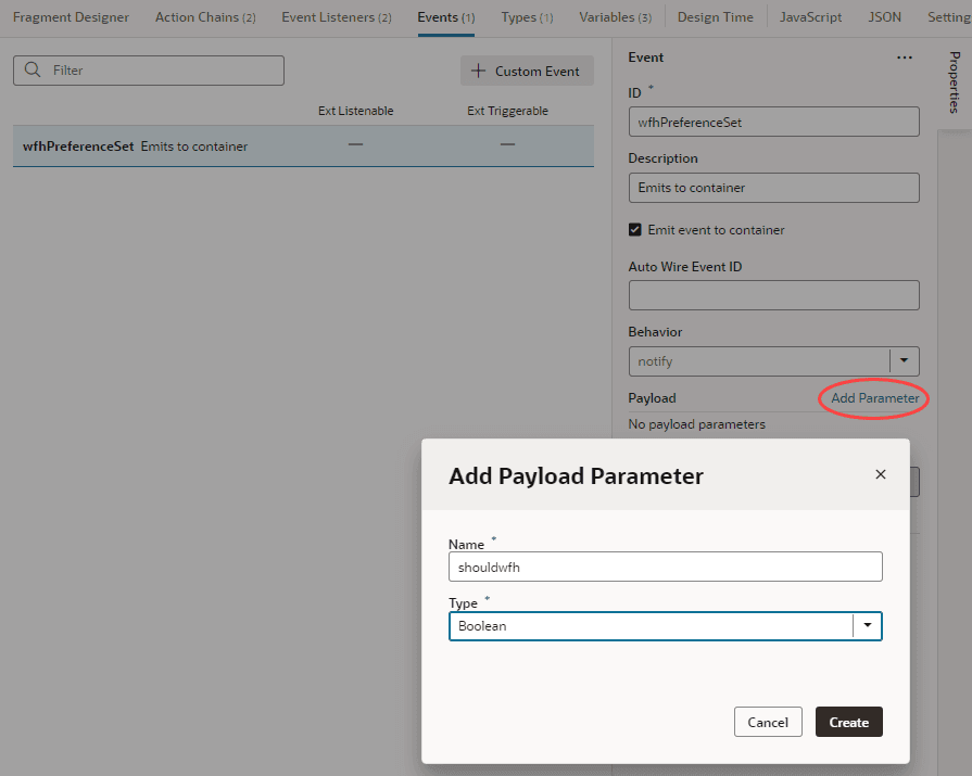

    8. When the new event is created, click Go to Custom Event under the new event to go to the Events editor and define the event’s payload.
    9. In the wfhPreferenceSet event’s Properties pane, click Add Parameter next to Payload. In the Add Payload Parameter dialog, enter an ID (say, shouldwfh), select the type as Boolean, and click Create.
      Description of jsac-fragment-event.png follows
      Tip: To simplify the task of creating an event listener for this event on the fragment’s parent container, you can choose to enter an Auto Wire Event ID (for example, wfhPreferenceSetAutoWire). This option enables the wfhPreferenceSet event to be listed under Fragment Events when you create a listener for the event from the Event Listeners tab on pages that use the fragment. See Automatically Wire a Fragment’s Custom Event to the Parent Container.

    11. In the Fire Event action’s Properties pane, hover over the shouldwfh property under Parameters, click Select Variable to open the Variables picker, and select value under Input Parameters.

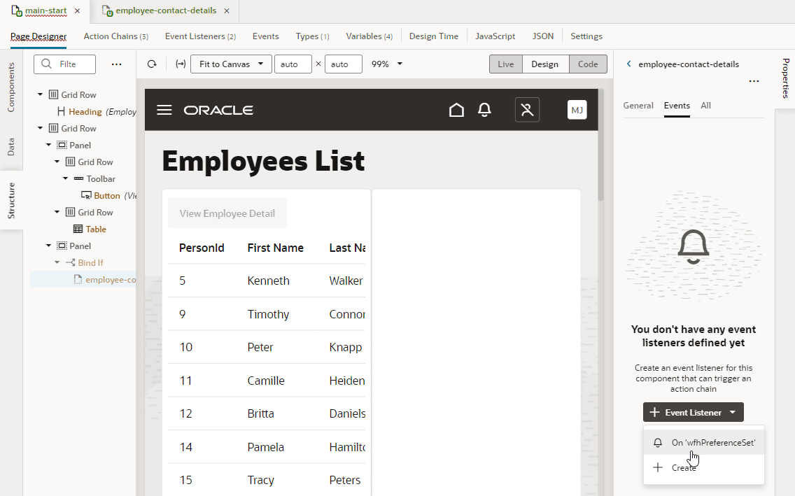

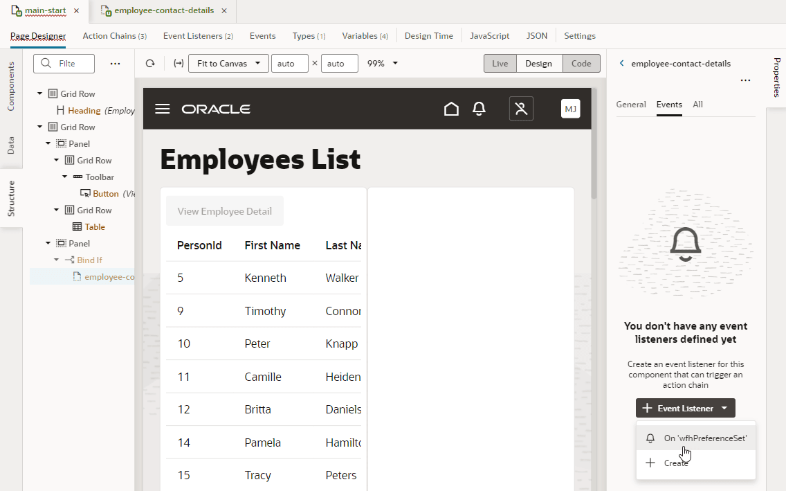

    1. In the Page Designer, select the fragment, then in its Properties pane’s Events tab, click + New Event and select the On ‘wfhPreferenceSet’ custom event.
      Description of fragment-data-container-emailpreferenceevent1.png follows
      Description of the illustration fragment-data-container-emailpreferenceevent1.png

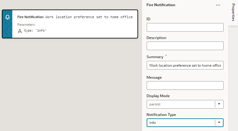

    2. Drag and drop a Fire Notification action to the FragmentWfhPreferenceSetChain action chain.
    3. Enter a summary in the Properties pane, something like Work location preference set to home office, then select Info as the Notification type.

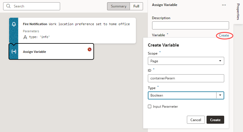

    4. Now drag and drop an Assign Variable action under the Fire Notification event.
    5. In the action’s Properties pane, click Create next to the Variable property. In the Create Variable dialog, add a new page-level variable (for example, containerParam) of type Boolean and click Create.

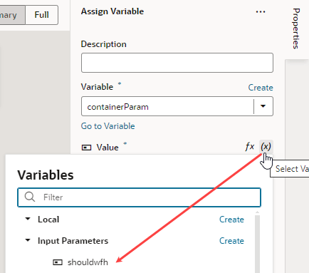

    6. Hover over the Value property and click Select Variable to open the Variables picker, then select shouldwfh under Input Parameters.

  3. Now return to the Page Designer, click Live in the toolbar, select an employee, and toggle Work from home?. You’ll see a message that the employee’s work location preference is set.
