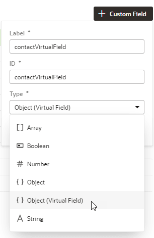

  1. Open the dynamic table or form you want to work with in the Layouts tab.
  2. Click the Fields tab, then + Custom Field.
  3. Enter a label for the field (the field’s display name) and select the Object (Virtual Field) type. Click Create.
    Description of custom-field-create-virtual.png follows

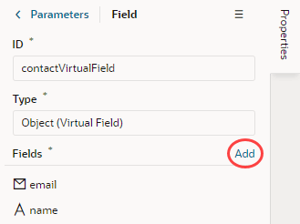

  4. In the Properties pane, click Add next to Fields and select the fields you want to include as reference fields. You can add any field in your layout as a reference field, including sub-fields of objects.
    Description of custom-field-virtual-addref.png follows

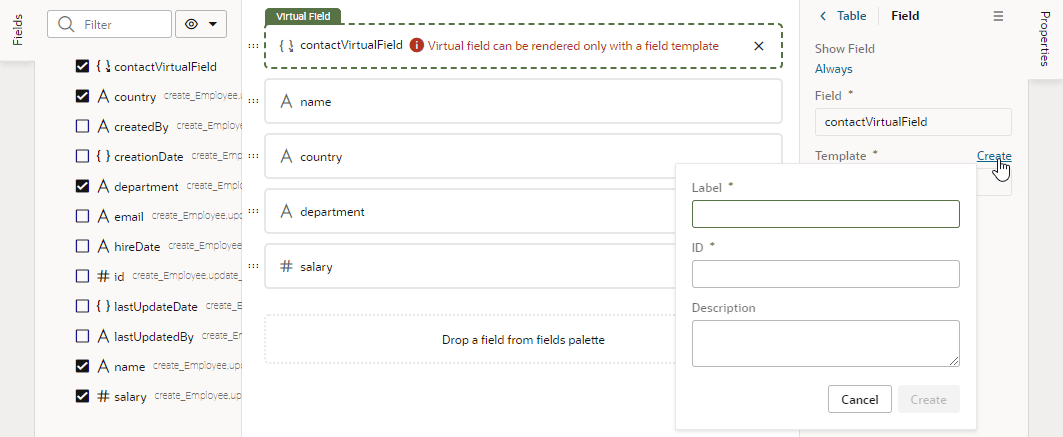

  6. In the Rule Sets tab, open the layout in the dynamic component where you want to add your field.
  7. Add the virtual field to the layout. You can drag it from the Fields palette into the center pane, or select it in the list and then adjust its position in the center pane.
  8. While your virtual field is selected, define a field template for the virtual field when you add it to a layout.
    If a suitable field template for the virtual field already exists, you can select it in the Template drop-down list in the Properties pane.
    If no template exists, click Create and enter a name for the template in the Label field. Click Create to open the new template in the editor.
    Description of custom-field-virtual-template.png follows
    In the template editor, add a component and define the properties for each referenced field in the virtual field that you want the template to display. Click Return to layout when you’re finished.
    The template is applied to your virtual field.
