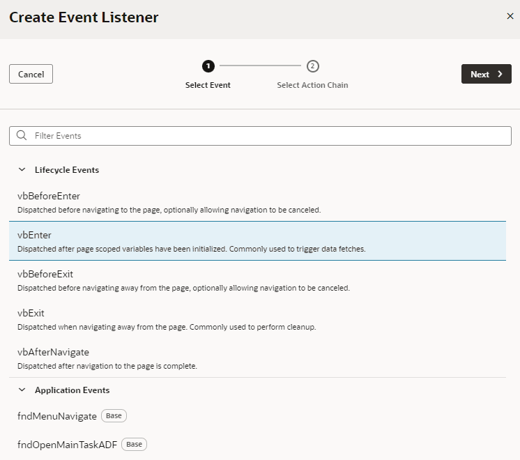

When an event (such as a button click) occurs in a page, it can start one or more action chains if an event listener is "listening" for it. To create an event listener, you select the event it should listen for and the action chain you want it to trigger. You can create event listeners for custom events as well as for predefined lifecyle events.
An action chain can be started by multiple event listeners, so you might have a SaveData action chain that can be started by two different event listeners listening for two different events.
To create a listener for an event and associate it with an action chain:

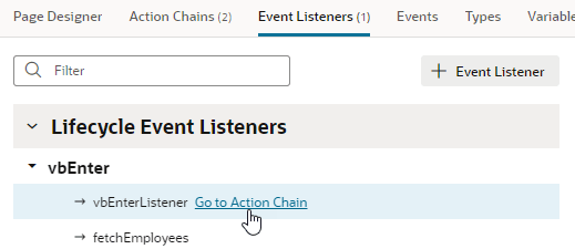

                  If you chose to create a new action chain, look for the associated event listener, typically prefixed with the event you chose. For example, if you selected vbEnter as the event, a new event listener called vbEnterListener is created under Event Listeners.
To edit an action chain associated with an event listener, move your cursor over the action chain (or select it), then click Go to Action Chain to open the action chain in the Action Chains editor.
