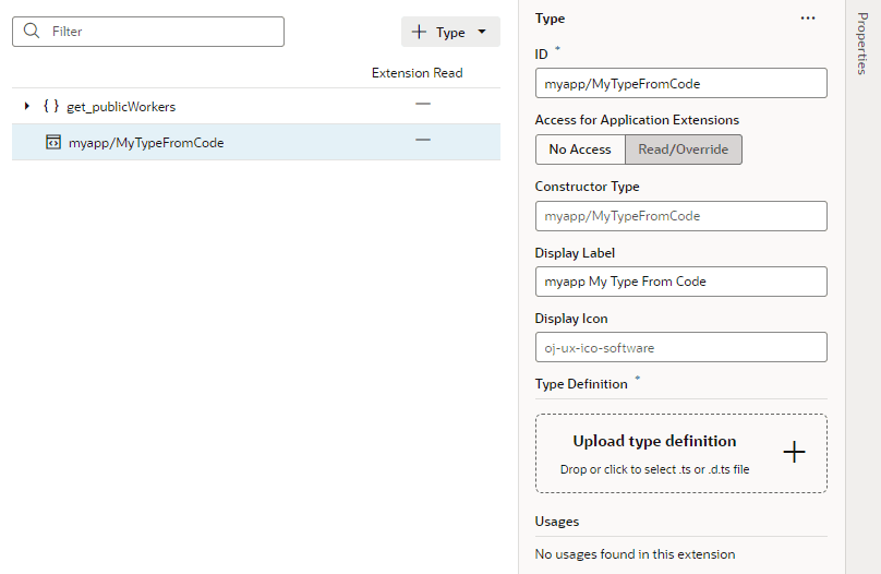

  6. Drag and drop into the drop target area (or click Upload type definition to provide) a typescript (.ts) or typescript definition (.d.ts) file that specifies the type’s details:
    Description of typefromcode-typedefinition-appui.png follows
    VB Studio converts your type definition to a JSON representation, then saves the JSON file under the App UI’s resources/typedefs/myapp folder, where myapp is the namespace specified when you initially created the type.

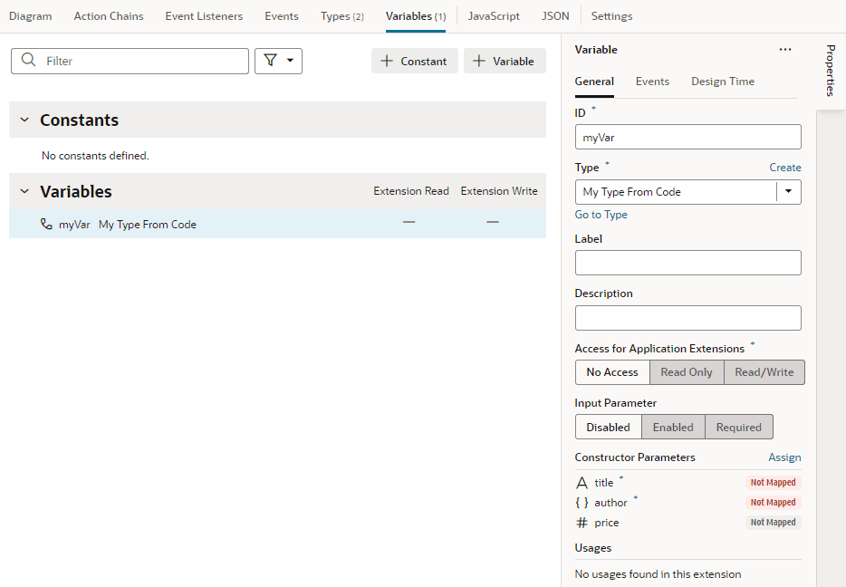

After you’ve created a type from code, you can create a variable for this InstanceFactory type, just as you would for any other type on the Variables tab. For example, here’s a myVar variable assigned to the My Type From Code type:
Description of typefromcode-variable-appui.png follows
However, because an InstanceFactory type includes a constructor, initializing InstanceFactory type variables is not the same as other variables. It requires parameters to be mapped to the constructor. To do this, click Assign in the variable’s Properties pane, then map the constructor parameters.
The shape for the constructor parameters comes from your type definition file. Here’s an example type and variable declaration as shown on the JSON tab:
