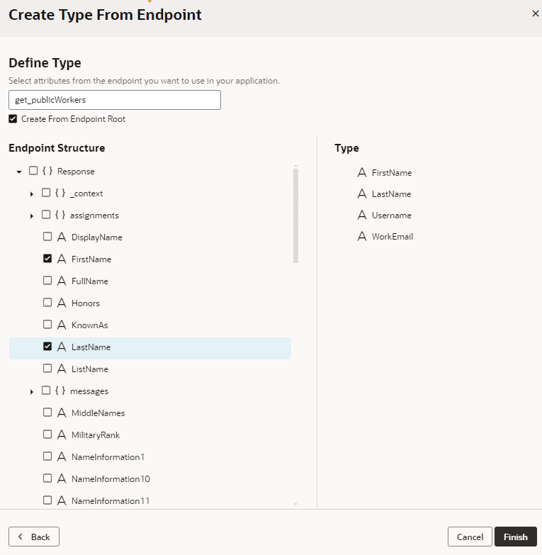

- Click + Type and select From Endpoint.
- Select an endpoint from the list. Click Next.
- Select the endpoint attributes you want to include in the data structure. Click Finish.

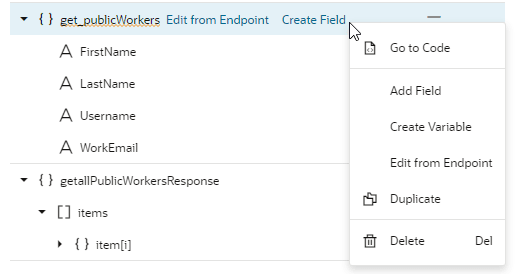

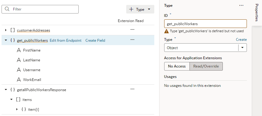

When your new type displays in the Types editor, you see it is an object type containing the endpoint fields you selected.
Use the options in the right-click menu to take further action (for example, to create a variable for this specific type or to add more fields from the endpoint).
Description of the illustration var-type-fromendpoint-righclickmenu-appui.png
When the type is associated with a variable, you can view its usage information under Usages in the Properties pane (for example, which variables are based on it and which pages use those variables). You can click a usage to readily navigate to that page.
