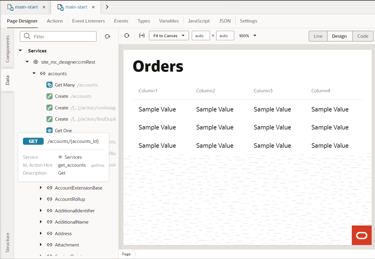

In this example, the service connection site_mc_designer has been created for this extension, based on the crmRestApi in the Oracle Cloud Application catalog. Within that connection, the endpoints for the accounts REST API are displayed:
Description of datapaletteget.png follows

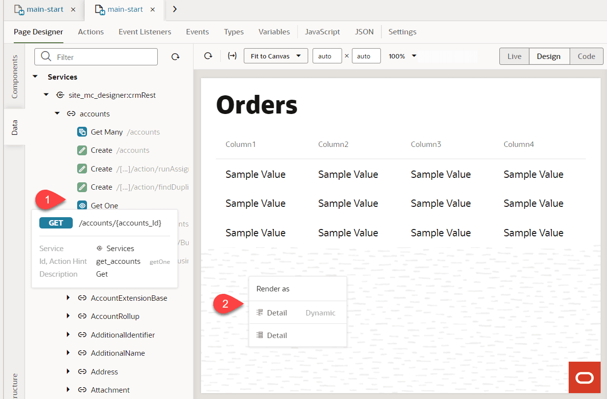

Suppose you want to show account data on a page. You would simply drag an endpoint from the Data palette and drop it on the canvas. (You can drop a data element on the page canvas, in the Structure view, or in Code view.) When the Render as pop-up appears, you can choose from the list of components that VB Studio suggests based on the REST endpoint you’ve chosen:
Description of datapaletterenderas.png follows
Notice that both dynamic and standard options are shown. Once you select an option, the corresponding quick start opens, to walk you through the required configuration tasks.
