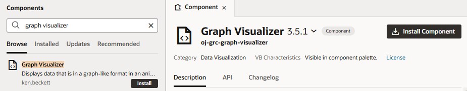

- Browse: Use to search the Component Exchange for components that can be installed, to open a component's details page, and to install components.

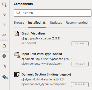

- Installed: Use to view a list of installed components. The tab displays details about each component, and components are badged to indicate warnings or available updates.

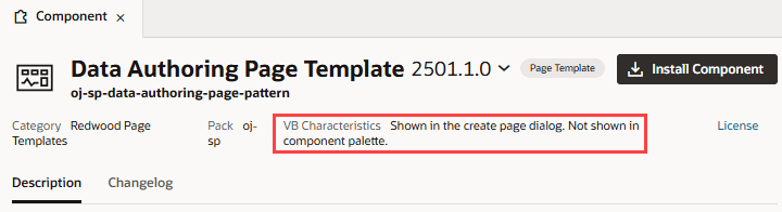

If the component you installed does not show in the Components palette, open it from the Components pane and check VB Characteristics to see why. For example:- If you installed a Redwood pattern that's meant to be a page template (for example, the Data Authoring Page Template), you'll find it in the Create Page dialog, not in the Components palette.

Some components (like
oj-dynamic-), in addition to being deprecated, may be legacy components that have been replaced by variants. While these legacy components can still be installed, they won't show in the Components palette because they cannot be readily dragged and dropped onto pages. You'll need to use the Page Designer's Code view to use these components in your pages.
