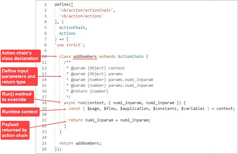

When you create a new action chain, VB Studio creates a code file with the basic class declaration for your new action chain. All you need to do is specify the input parameters and return payload types, if any, and to override the run() function. You can do all this through the code editor, visually through the Action Chain editor, or both. You can also create local functions, as needed.
Here’s an example of a simple action chain that returns the sum of its two input parameters:

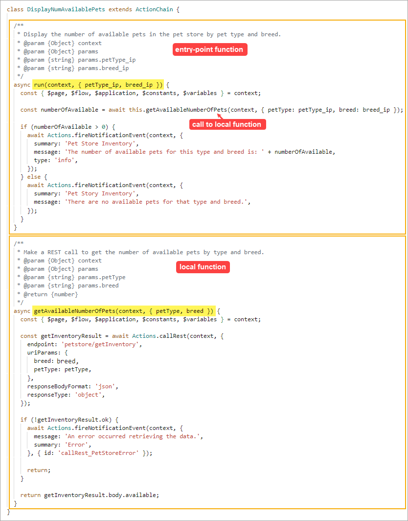

Local Functions
Should the need arise to break up the run() entry point function into modular parts, you can create local functions:
