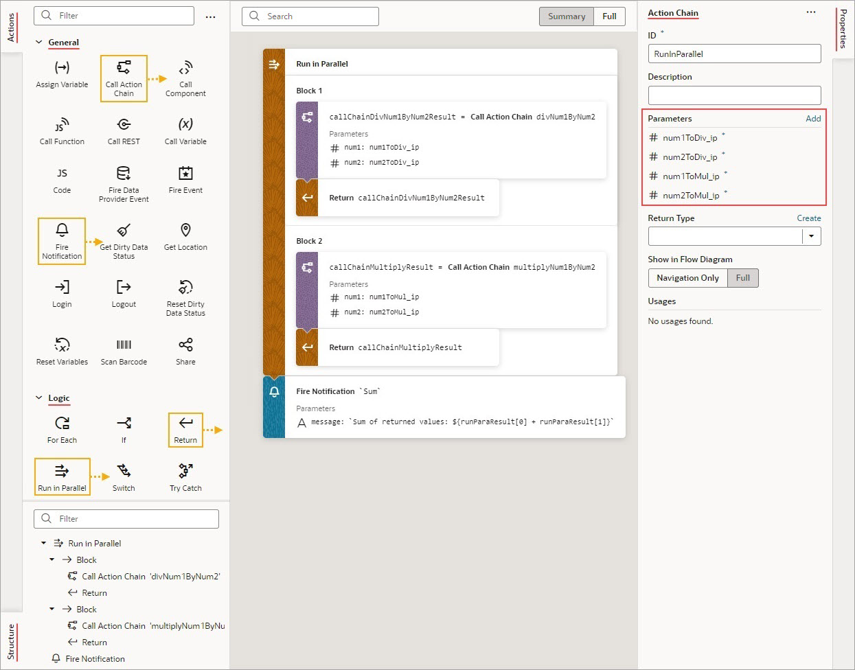

Here's an example of an action chain that runs two action chains asynchronously, and then uses the result from each to create a combined result. Through input parameters, the action chain receives four numbers, as shown in the Properties pane. Using the Run in Parallel action, one asyn() method is used to call an action chain that returns the quotient of two numbers, and another asyn() method is used to call an action chain that returns the product of two numbers. The Run in Parallel action returns an array (runParaResult, in this example), with the first element containing the value from the first asyn() method and the second element containing the value from the second asyn() method. The sum of the values is then displayed using a Fire Notification action:

const runParaResult = await Promise.all([
async () => {
const callChainDivNum1ByNum2Result = await Actions.callChain(context, {
chain: 'divNum1ByNum2',
params: {
num1: num1ToDiv_ip,
num2: num2ToDiv_ip,
return callChainDivNum1ByNum2Result;
async () => {
const callChainMultipleNum1ByNum2Result = await Actions.callChain(context, {
chain: 'multipleNum1ByNum2',
params: {
num1: num1ToMul_ip,
num2: num2ToMul_ip,
return callChainMultipleNum1ByNum2Result;
].map(sequence => sequence()));
await Actions.fireNotificationEvent(context, {
message: `Sum of returned values: ${runParaResult[0] + runParaResult[1]}`,
summary: `Sum`,
});When creating action chains, keep in mind that each action chain has a scope that depends on where it's defined: at the App UI, flow, page, or fragment level. An action chain defined at the App UI level can be called from any flow or page, but a page-level action chain can only be called from that page— however, the chain itself can access variables defined on the page, parent flow, or App UI. The same goes for flow-level action chains. A fragment-level or layout-level action chain can only be called from that fragment or layout, and the chain can only refer to variables defined in that fragment or layout.
