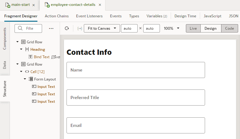

- First off, set up a fragment to display an employee's contact information. For demonstration purposes, let's assume your fragment looks something like this, with a Heading and Input Text components:
To provides values to these components, we'll create a type and a variable that holds this information, retrieved from the

get_publicWorkersas the type) is created on the fragment's Variables tab. - Switch to the Fragment Designer and bind each component to the
get_publicWorkersvariable's corresponding value. For example, to bind the Name component to the employee's name, select the input text component, then in the component's Data tab, hover over the Value field and click
to open the Variables picker. Select DisplayNameunder theget_publicWorkersVarfragment variable.

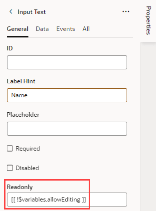

allowEditingvariable, then under Input Parameters in the Properties pane, select Enabled to pass the variable's value as an input parameter to the pages that use the fragment. - Switch to the Fragment Designer and bind each Input Text component's Readonly property to the
allowEditingvariable. For example:- Click the Name Input Text component, then in the component's Readonly field in the General tab, click
to open the Variables picker and select allowEditingunder fragment variables. - Add an exclamation mark (!) before the dollar sign ($) to indicate that the field is read-only when the fragment is not in edit mode.

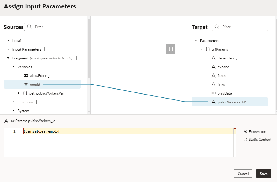

publicWorkers_Idto open the Assign Input Parameters dialog. On the Sources pane, click + next to Fragment and create anempIdvariable of type number (you can choose to enableempIdas an input parameter even now, but for demo purposes, we'll do this in a later step). Click Create. Now dragempIdfrom the Sources pane topublicWorkers_Idon the Target pane. Click Save. - Now double click the Assign Variable action in the palette to add it to the end of the action chain. In the action's Properties pane, select

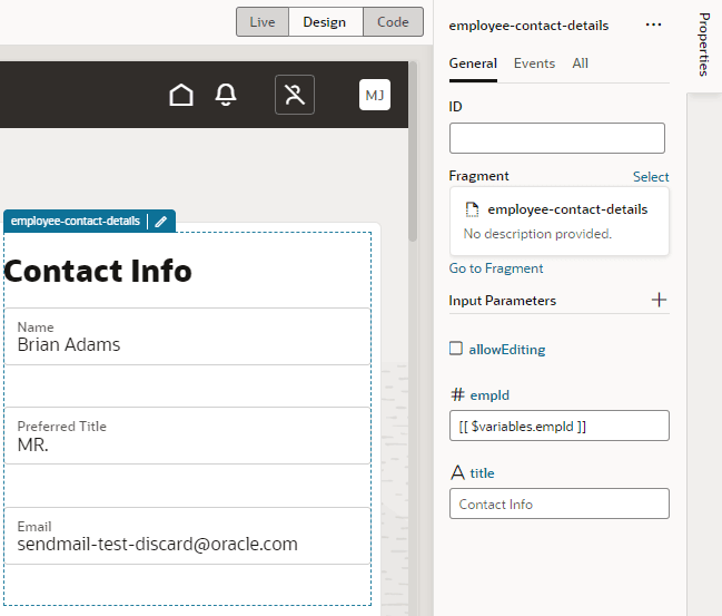

- Open the page with employee data that you want to add the fragment to.
- In the Components palette on the Page Designer tab, search for the employee contact information fragment, then drag and drop it where you want it to display.
Take note of the fragment's Properties pane on the page. Because we marked the
empIdfragment input parameter to be autowired on the fragment container, theempIdvariable is automatically created on the page (look in the Variables tab) and wired back to the fragment input parameter's value (92 by default). - To make the employee's contact information editable on this page, select the

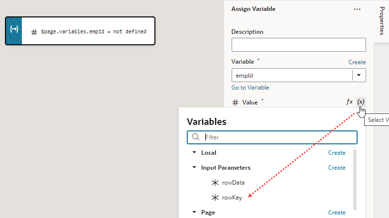

- Click the table component on the page, select the Events tab, then click + Event Listener and select On 'First Selected Row' to retrieve information about the selected row.
- When the
TableFirstSelectedRowChangeChainaction chain is created, drag and drop an Assign Variable action. - In the action's Properties pane, select the
empIdvariable under Page in the Variable drop-down list. Now use the Variables picker on the Value property and selectrowkeyunder Input Parameters. - Return to the page designer and click Live, then select a row in the table to see employee contact information reflected in the fragment based on the ID.

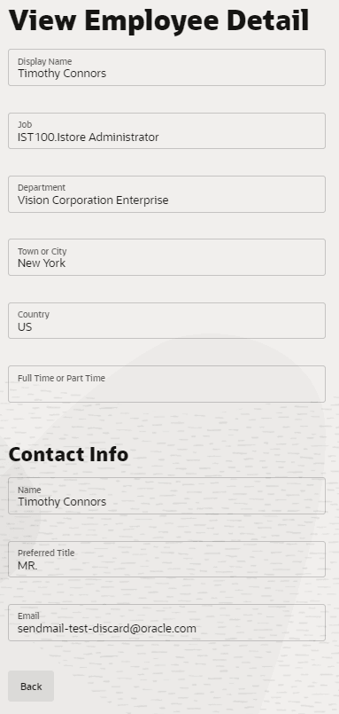

- In the Page Designer, select the table and add a detail page using the Add Detail Page quick start.
- Click Live, select an employee in the table, and click View Employee Detail to open the newly created edit page.

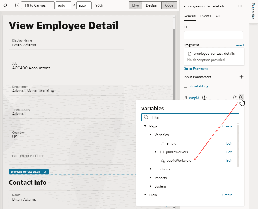

- Add the contacts fragment to a page, similar to how you added it to the other page previously.
- To make sure the selected employee ID is passed between the page and the fragment, select the Fragment and on the
empIdinput parameter in the Properties pane, select thepublicWorkersIdvariable.

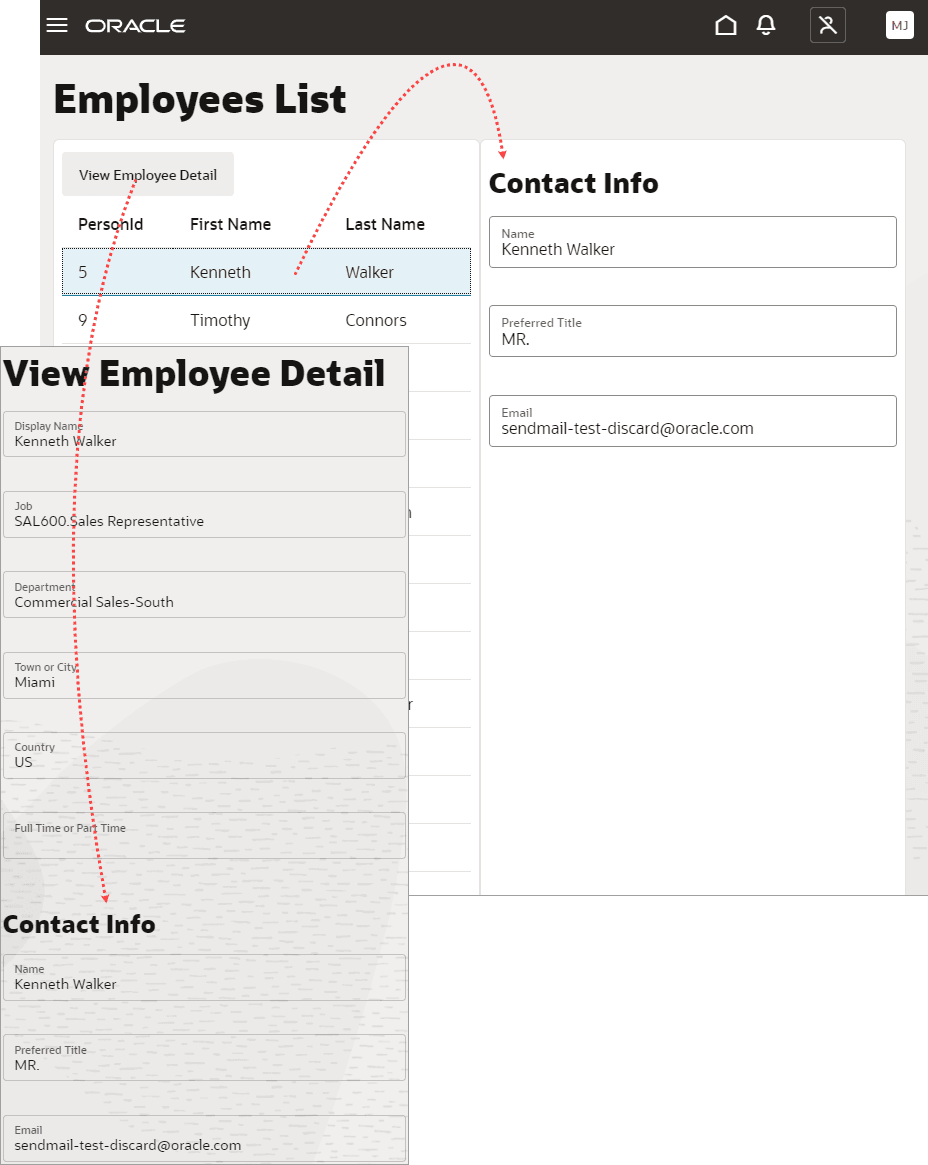

- As a final step, switch to the main-start page, then click the Preview icon in the header.
- Select a row in the table to see the employee's contact details display on the right. Notice how contact details from the fragment show as editable values.
- Click View Employee Detail for the selected row to view the employee's information, including contact details, on the View Employee Detail page.
